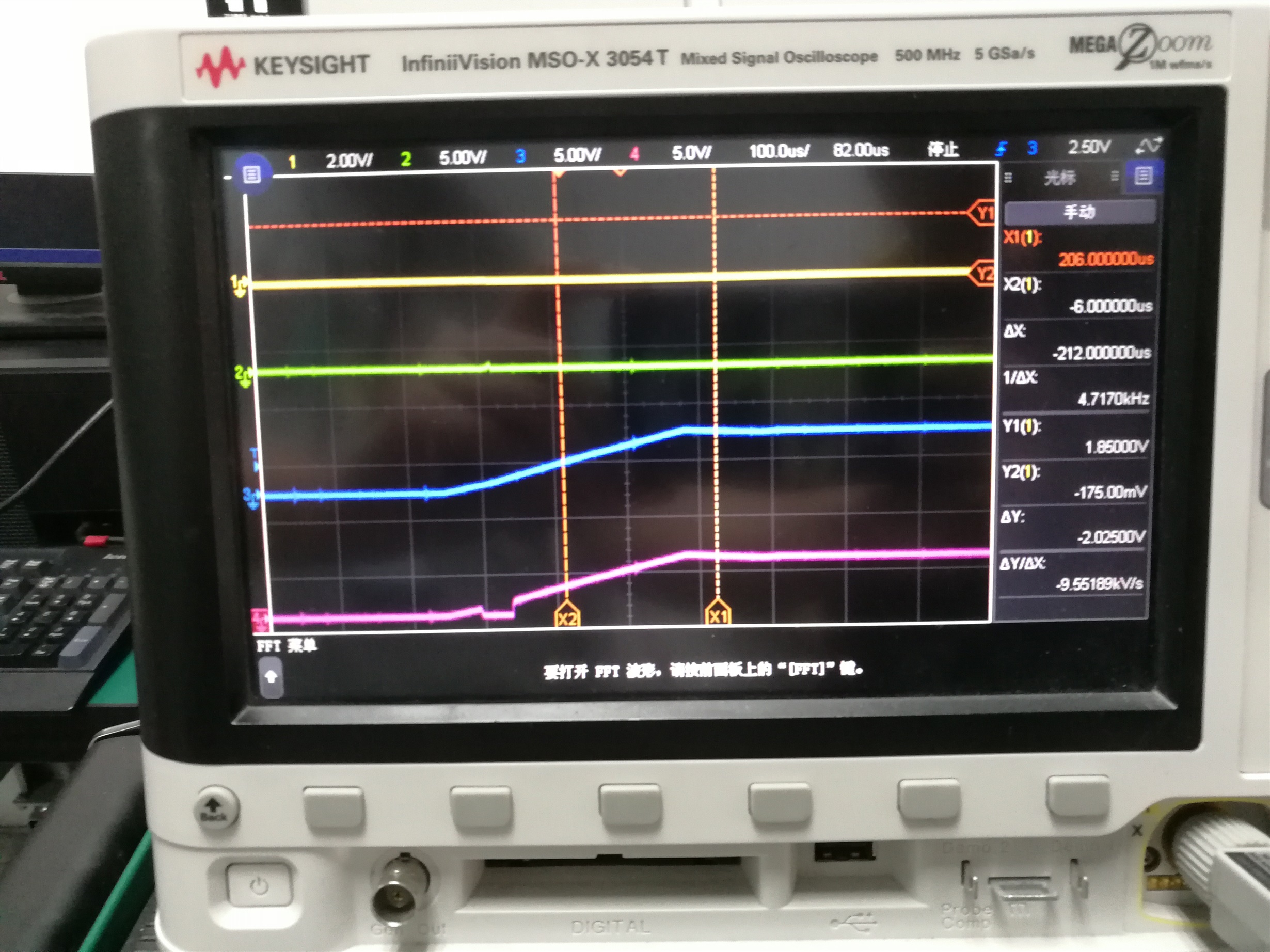

The following problems were found during the test.(Yellow: power, Green: 4 pin, Blue: 5 pin, Pink: 7 pin)
1.When the temperature is -40 °C, the low-voltage power-on and power-off test is performed.
> When the power is off after a long time (about 20s or longer) and then power on, the measured waveform is shown in Figure 1. No collision will be reported.
> When the power-off time is short (at this time power supply voltage has reduced to 0) and then power on, the measured waveform is shown in Figure 2. When the collision fault is reported, you can see that the input of the device has a spike and the voltage is about 1.6V - 1.8V, the output of the device is high, as shown in Figure 2;

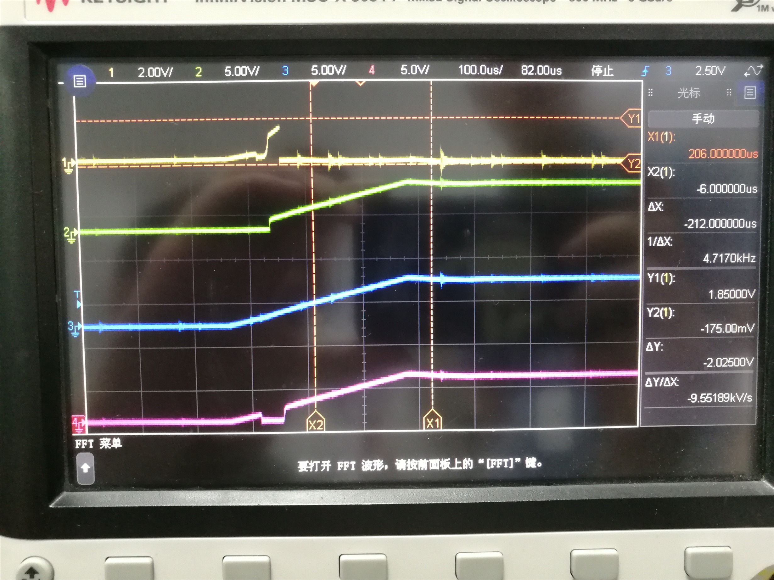

2.  When the temperature is adjusted to 25 ° C, the test waveform is shown in Figure 3.

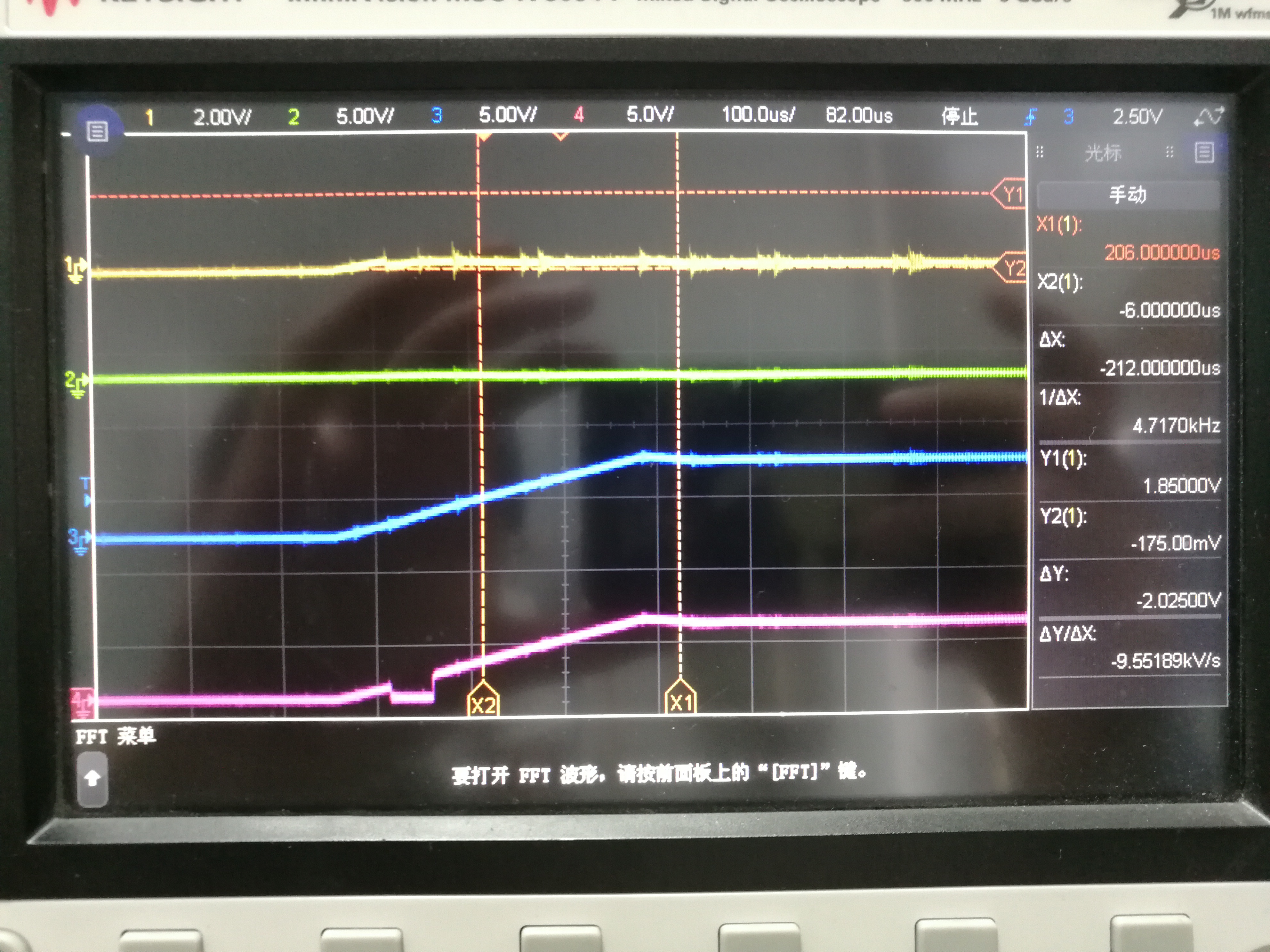

    > When the power-off time is short (at this time power supply voltage has reduced to 0) and then power on, the measured waveform is shown in Figure 2. When the collision fault is reported, you can see that the input of IC3903 has a spike and the voltage is about 1.6V - 1.8V, the output of IC3903 is high, as shown in Figure 2;
    4.The pin11 is connected to the 32.76kHz crystal oscillator. The waveform is as follows: yellow is the chip power supply, green is the counter 4 pin, blue is the counter 5 pin, pink is the counter 11 pin.

  • Hi Sherry,
    This is what I believe is happening. The device is powering up very slowly. So when Vcc is about 1V, the switching threshold is at 500mV. This means that those small oscillations at the clock input might be causing the counter to increment. The clock input is not disabled because your clear pin is low during this whole time. Then when the clear pin jumps high, the outpus will go low. It is not the device but I believe your crystal oscillator that is becoming noisier at the low temperature. Can you provide a scope shot of the counter 11 pin when operation is normal and incorrect again but zoomed at the incident point so we can see the noise? And my assumption is when you wait a long period of time it allows the crystal oscillator time to turn off. (I don't have too much knowledge on crystal oscillators).
    Here is what I see:
    The solution would be to make sure CLR pin stays high and doesn't go low as it visibly does in those scope shots, or to make sure your CLK input pin is low or grounded at startup.
    Thanks!
    -Karan

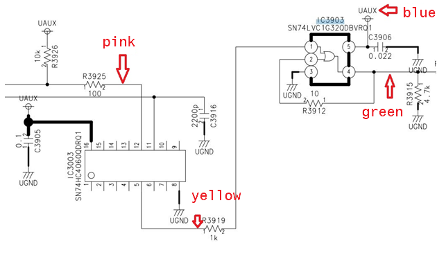

    The customer's schematic is as below. The clear pin will be pulled up once power up, but the power UAUX has a rise time as the second picture.
    This fault occurs around 1V which is outside of the normal voltage range, but the fault is related to the temperature. Because the fault doesn't occur when the temperature is 25℃ or higher. Do you have any idea about why the fault occurs at the negative temperature?

  • Hi Sherry,
    The Clear pin is not raised to the same voltage as the blue signal when the fault occurs.
    I cannot say why it will happen at certain temperatures over another when it is operating outside the datasheet specs.
    They should try delaying power up of this device after the supply pins have ramped up. This way they can hold the clear pin high when they are turning on this device.
    Thanks!
    -Karan
