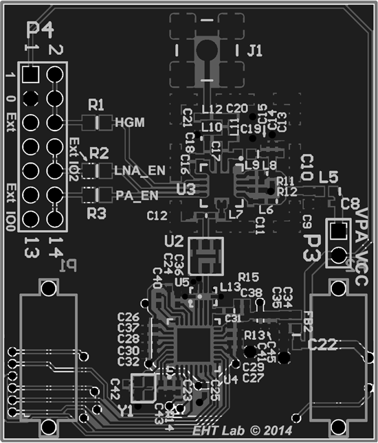

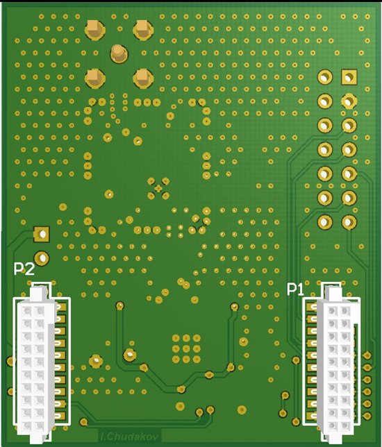

    Here are pictures of my layout: top layer gerber, board drawing and two 3D pictures. Stitches will do later before sending to fab.
    Please, take a look.
  • - Looking at the 3-D plot it looks like not all vias under CC112x and CC1190 are connected to the ground plane on the other side of the board.
    - Check the recommended layout for the SAW filter. (check Epcos website)
  • Fixed the library and made some additional small changes
  • The  first time I looked at this I think I didn't see clearly which caps were where. The placement of C20 and C19 is not optimal. The ground connection for those two are fairly close to each other and part of the signal could go here instead of being filtered. Looking at the layout it should be possible to move the SMA to the right and swap C20 and L12. C20 and C19 should point in opposite direction.
  • TER,
    That is interesting point about moving the SMA to the other whole in the RF shield and changing L&C places accordingly. Will do and post again.
    Thanks.
  • TER,
    Moving the connector to the right side makes the output trace longer. Originally I tried to do it as short as possible. Anyway, please, take a look
  • The track is still short, no problem. It looks like you have forgotten a couple of vias on the ground connection point of C20/ C21?
  • Honestly, I thought that since I already have ground everywhere, I could eliminate those vias. Wrong assumption? Ok, I will put them back when finalize the board. Need stitching anyway.
    What about anything else?
    I also thought about partial separating of digital and analog RF ground that they would connect only in one place in the middle or on side of the board. Do you think it might be useful?
  • Put back the vias.
    Anything else except stitching?
  • Yes, a decoupling cap should always have a via to ground. Looks like you need more vias around the radio. I assume you use the same stack-up as the ref design.

  • Normally we recommend a 4 layer design for a combo using CC1190. Mainly two reasons for this:
    - Ground. Most 2 layer boards I have seen has a poorer ground plane compared to 4 layers. In you case the ground looks good as far as I can see
    - The impedance change. With a 2 layer design the ground vias have larger impedance than in a 4 layer design. The impedances in the ref design are tuned with 0.4mm between the signal and the ground layer. If you use a 2 layer board the distance is typically x2 or x3.
    When using +27 dBm the power level is high requiring a good layout. Not sure if a 2 layer design will work.
