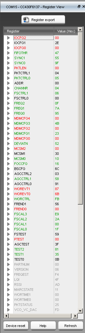

while evaluating the TI chronos with the SmartRF Studio 7 (version 1.4.9 and 1.3.2) I observe the register content of the CC430 is often partially lost. This is observable with two effects:
first: the device does not work as expected (e.g. channel spacing in the RF parameters does some times not match the effective register content (observable in TX with a spectrum analyzer))
second: every time I read the register contents back with the "Refresh" button, i get new register contents differing from what was programmed (highlighted in red) for example in the MDMCFGx registers.

  • Hello Bjoern,
    for the second problem: I just load a complete configuration file that was previously saved. I can then observe in the log window, that the registers are all written. When I then hit the button "refresh" below the register list, I get changed values. The affected registers are highlighted in red. See image below.
    It seems as always the same registers a lost, when i try the "refresh" button.

    Thanks  for the description. For the second problem, I can confirm that I see the same here. I think the problem is caused by some registers are written during loading of the config which should have been write protected i.e. if you systematically remove some of the registers from the saved config file you will see that the problems disappear.
    We will investigate this further and hopefully fix it until next version of SmartRF Studio.
    Bjørn
    thanks for the workaround. Indeed, when I delete some of the register contents in the XML config file, the error with the lost/changed register contents goes away.
