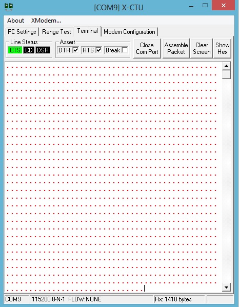

  • Thank you. You really helped me a lot. I actually have the Xbee as the coordinator and the CC2530 like the End device talking to each other .The problem was the way that I was sending the message: The terminal needs that the message will be sent by the serial port or at least written like it will be sent by serial port.
    Thanks again !!!

  • Thanks alot my Xbee just came in the mail, i have run into the same problem i have config it correctly (ROUTER AP) i think because it has automatically set my coordinators ID as its own but the range test just comes up blank so i cant tell if its receiving anything . the XBee is connected to by laptop via Sparkfun's Xbee USB.
    "emma castillo -  I actually have the Xbee as the coordinator and the CC2530 like the End device talking to each other .The problem was the way that I was sending the message: The terminal needs that the message will be sent by the serial port or at least written like it will be sent by serial port."
    im not sure what he meant or how he manged to fix it, any help would be great.
