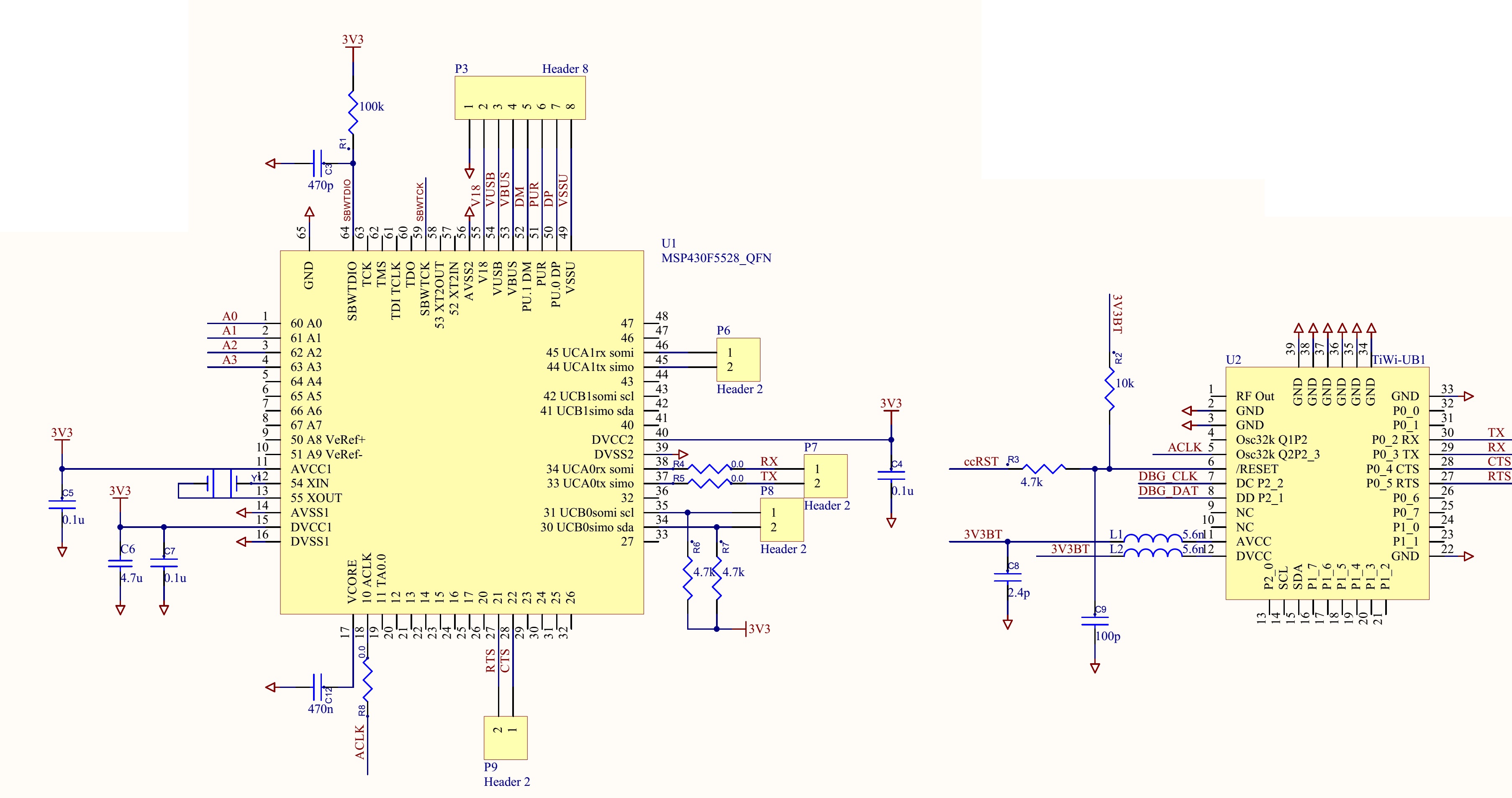

  • Hi Aslak, thank you for the response. We are using a network configuration using an MSP430 and the CC2541. For our clock, we have an oscillator for the 32MHz clock on the MSP430, and this clock is being sourced from pin 1 to the CC2541 32MHz clock. So in other words, the CC2541 is using the clock from the MSP430, it does not have its own oscillator/crystal.

  • So when using the LSR module I assume you set the jumpers JMP1 and JMP2 to position 1-2, is that right?
    Why the LSR module doesn't work properly when doing this is hard to say. Several components such as the 32 MHz crystal is probably hidden within the module itself.
    Would you be able to share a schematic with us of your solution?

  • That's right, both jumpers were in position 1-2. I've attached the schematic, it is pretty simple. There are some breakout pins not shown, but this is everything relevant.
    There's one more thing I thought of. There are four UART lines connected to the tiwi-ub1 which will be used in the actual solution. They are not used in SimpleBLEPeripheral example however, so I wonder if they are interfering in some way.
