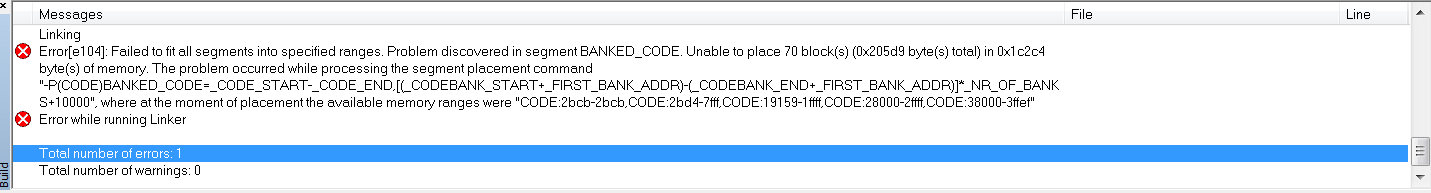

    Has anyone achieved this in order to give us some guidelines, please?
    I am trying the HostTestRelease Project (Stack 1.4.1) and more specifically, the CC2540SPI version on cc2540  with 128K flash.
    and the the preprocessor settings :
    INT_HEAP_LEN=3072
    HALNODEBUG
    OSAL_CBTIMER_NUM_TASKS=1
    HAL_AES_DMA=TRUE
    HAL_DMA=TRUE
    xPOWER_SAVING
    xPLUS_BROADCASTER
    HAL_LCD=TRUE
    HAL_LED=FALSE
    SERIAL_INTERFACE
    HAL_UART=TRUE
    HAL_UART_DMA=1
    HAL_UART_ISR=0
    HAL_KEY=FALSE
    GATT_DB_OFF_CHIP
    and I get this error:
    Could anyone help me please?
