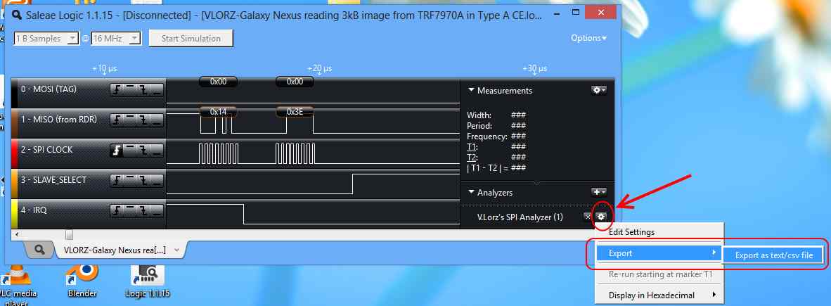

  • Victor,
    This sounds great!  I tried to use it, but maybe I am not selecting the correct export settings as i dont see the analyzed data as shown in your screenshot.  Can you please clarify what export settings you used?  Thanks!
  • Hi Eddie,
    Click in the 'Settings' icon for the Analyser and select the option 'Export', then 'Export as text/cvs file', like in the image below.
    If I find some time in the future, I'll give it one more apporpiated name for the analyzer and make the source code also available.
    Not all registers are decoded, only the ones that were of help for us.
    --Victor
  • ...sorry, I forgot this 'small detail'.
    One more thing, for properly decoding and grouping in transactions the analyser needs data from all of the following channels: MISO, MOSI, CLK & ENABLE.
    In case of any of the four channels is missing, the analyser reverts the export generator to the same as the original SPI analyser.
    --Victor
  • Thanks.  I was trying to export the data from the "Options" menu.  This looks pretty helpful so far.  Thanks for sharing!

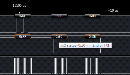

    • The most usefull or important change comes in that we updated the bubbles generation support so decoded values are now shown there by placing the mouse cursor over.
    Here are some screen captures. This first one is Note++ showing the new output format.

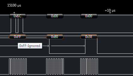

    These three images below show the new bubbles support. For reproducing it, place the mouse cursor over the bubbles that represent the bus values. Meaningless bytes (MOSI when reading, MISO when writing) are shown as 'Ignored'.

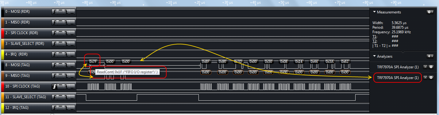

    This last one also shows the new bubbles support. Center the graph in the byt of interest and zoom-in.

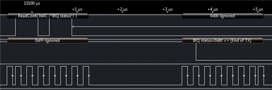

    Here is a screen capture, just for reference.
