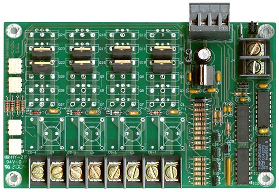

It is possible to multiplex two(or more) antennas using the RI-RFM-008B-30 model. And as would be connected?
Thanks for the help.

Hello Nicolás,
We have a license to manufacture the old RI-MOD-TX4A four antenna multiplexer board for the RI-RFM-008B module that was discontinued a few years ago. The TI data sheets can still be found by googling that part number or I can provide one. Contact me at warren@oregonrfid.com to order them.
When multiplexing antennas the read rate per antenna divides down so at 10 scans per second, four antennas will be scanned at 10/4 = 2.5 scans per second per antenna. Two antennas will scan at 5 per second per antenna. If this is too slow then the solution is to synchronize multiple readers to get full read rate at all antennas.
