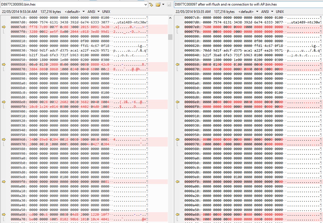

  • Are you calling any host driver functions  which write to the NVM? If one of these is called upon each startup you could be hitting the write cycle limit.
    E.g. netapp_dhcp() or one of the nvmen_* set/write functions?
  • seems plausible... see a potentially related cross-posting here http://e2e.ti.com/support/low_power_rf/f/851/p/334303/1171028.aspx#1171028. I'm just using the Adafruit_CC3000_Library and using the pattern in all the examples to connect to the same network over and over again. The call sequence at the top level (above the TI host driver) is I think summarized as:
    cc3000.begin()
    cc3000.deleteProfiles()
    cc3000.connectToAP(WLAN_SSID, WLAN_PASS, WLAN_SECURITY)
    cc3000.checkDHCP()
    ... then post some data to a website, rinse and repeat about once or twice a minute.
    I'm not in a position to access the source I'm using in an easily grep-able form right now, but it doesn't seem terribly unlikely that netapp_dhcp is getting called in that sequence, for example
  • Sorry I am not familiar with the adafruit library internals.
    If deleteProfiles() is calling wlan_ioctl_del_profile() then its possible this may be the cause since profiles are stored in NVEM.
    I don't see why you would be calling this with any regularity. Especially if you have not called the equivalent add profile function (wlan_add_profile()). (Unless it does something else completely different in this case).
  • I don't really want to get into a debate about the merits of the pattern. It was an experiment on whether it was a viable usage pattern to provide long term operation and stability, given the CC3000's relative lack thereof currently. Perhaps you're right and it would work if I simply removed the deleteProfiles call from the pattern.
    It's nevertheless important for me / the CC3000 community to understand the implications / constraints if the CC3000 can only connect to a network a limited number of times in its lifetime, or that you can only delete / write profiles a limited number of times, especially if some obvious usage patterns (like what I've described) might exhaust in a matter of weeks.
    Is there a proof-positive way to determine that the endurance of the NVRAM is toast?

  • Probably not a big help, but it looks like the NVRAM is a separate part inside the CC3000 module, see here an image from Adafruit.com:

  • The EEPROM is separate and its bus is not even connected internally to the rest of the CC3000 module. Instead you must connect its I2C bus externally as the CC3000 datasheet instructs at the bottom of page 4:
    (3) Connect SDA_EEPROM and SDA_CC3000 through a 0-Ω resistor.
    (4) Connect SLC_EEPROM and SLC_CC3000 through a 0-Ω resistor.
    This is good, since you can attach a digital oscilloscope or a logic analyzer to pins 27 and 28 and monitor the I2C bus. In your case if you do that you can compare the transmitted data of a good CC3000 with the bad one.
  • Ivor, can you clarify, are you suggesting that I should do a logic capture on the I2C lines at the 0-ohm loop-back resistors? I'm happy to do that, but I would like to understand how that might help.

    It appears that we are also suffering from this same problem. We have had a unit running in the field for almost one month when it suddenly stopped working; it would no longer connect to the access point it had been connecting to since installation.
    On interrogation of the EEPROM, we found that there were 32 bytes of (assumed) corrupted data in each successive 128-byte block of the WLAN configuration area. This same corruption was also seen in the WLAN config shadow area.
    The corrupted areas included the location of the AP’s SSID, so the unit could not possibly connect in this situation.
    I have attached a copy of the NVRAM content of the failing unit (nvram_fail.bin.txt) and a good unit, whose configuration profiles have been flushed, for comparison (nvram_good_after_wifi_flush.bin.txt). I’ve also added a snapshot of the comparison between the two to show the 32-byte blocks of corruption.
    We have not yet run any further tests on the CC3000 in case any important data is lost from the EEPROM.
    We are using patch SP 1.24 with API Version 1.11.
    Is there any information I can provide that will help diagnose this problem further?
    nvram_dumps.zip
