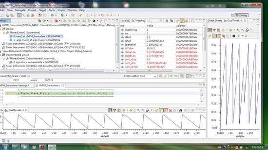

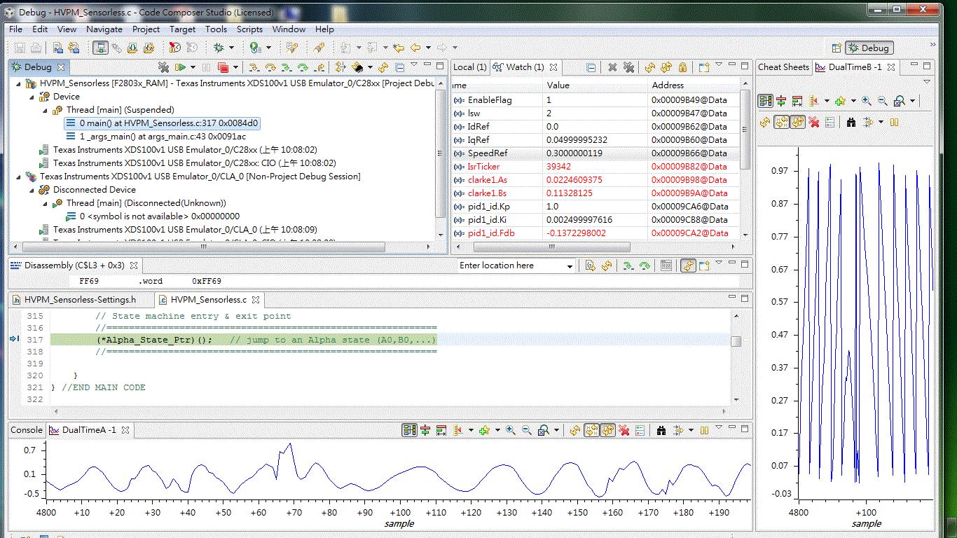

           I was still jiggle on level5.
          Maybe , I didn't tune fine PID on current loop.
         Did I tune PID on lsw=1???
         How can I tune it ???
         Check pid1_id.Fdb in the watch windows with continuous refresh feature whether or not it should be keeping track pid1_id.Ref for PID_REG3 module. If not, adjust its PID gains properly.
      Check pid1_iq.Fdb in the watch windows with continuous refresh feature whether or not it should be keeping track pid1_iq.Ref for PID_REG3 module. If not, adjust its PID gains properly.
      Jimmy
      Level5 - DualTimeA-1 : clarke1.As  DualTimeB-1: Smo1.Theta
      F28035 High Voltage Motor Control and PFC Developer's Kit

    • ChrisClearman
      Posted by ChrisClearman
      on Sep 02 2011 10:14 AM
      Mastermind24515 points
      Did you update the settings for your motor in HVPM_Sensorless-Settings.h?
      Are you following the user guide on how to tune the Id, Iq, and Speed PI controllers?
      C:\ti\controlSUITE\development_kits\HVMotorCtrl+PfcKit_v1.6\HVPM_Sensorless\~Docs
