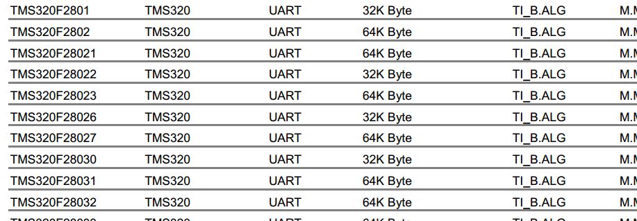

  • Amazed with this universal programmer! It would be more helpful if it had JTAG programming capability too and more devices support.
  • Hi Gautam,
    your community page is quite impressive.
    for your question FlashRunner line of programmers supports most ISP protocols (BDM, JTAG, SPI, I2C, MON, ICC, SCI,
    etc.) and this is the device list of all the silicon devices www.smh-tech.com/.../flashrunner-device-list.html
    Thank You!
    I'm fully aware of the supported devices and protocols but my main concern wrt C2000 devices. FlashRunner supports only UART for programming these chips and not JTAG. Also, the C2000 devices listed are very few and it does not include two of my favorites TMS320F28069 and TMS320F28335.
