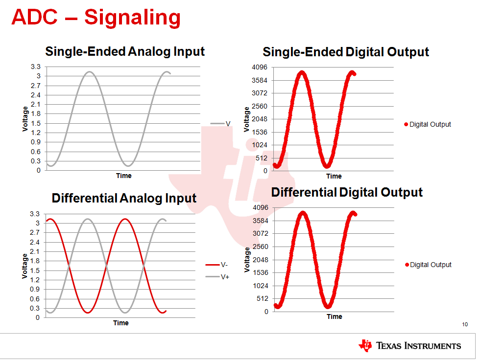

I have another question. I want to use the 16-bit ADC on F28377D. The 16-bit ADC only supports differential mode on . But the analog signal is single ended. Can I just connect analog signal to ADCINyP, and connect ADCINyN to ground? Thanks.
Xiaowei,
No, this won't work. The differential signal needs both inputs. In the datasheet, we spec' that the input common mode range is +/-50mV. This means that (ADCINp + ADCINn)/2 must be within 50mV of (VREFHI - VREFLO)/2.
If VREFHI = 3V, VREFLO = 0V, and the ADCINp is say 2V, then
(2V + ADCINn)/2 = (3V + 0V)/2 +/- 50mV
=> 2V + ADCINn = 3V +/-100mV, then
=> ADCINn = 1V +/- 100mV
So ADCINn = 0V won't work.
Essentially the negative signal should always be the compliment of the positive signal:
You should be able to get whatever signal you have into differential form by using a fully differential op-amp, e.g. THS4521.
