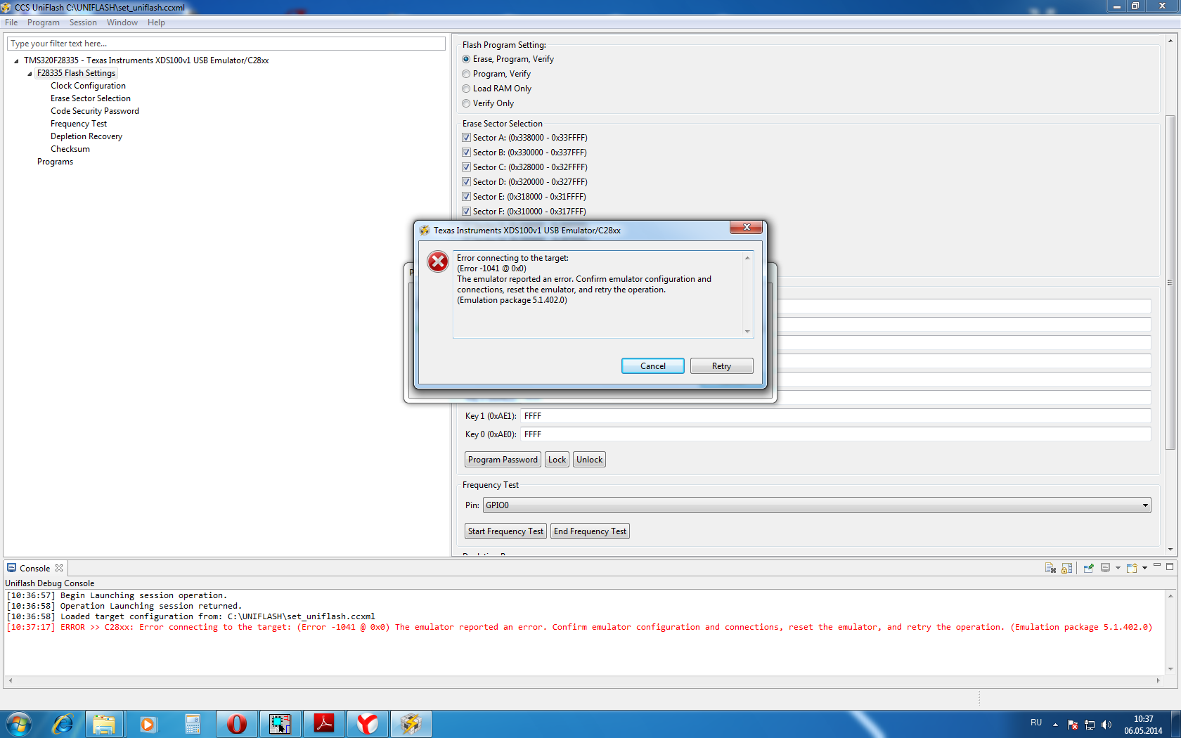

How to unlock TMS320F28335

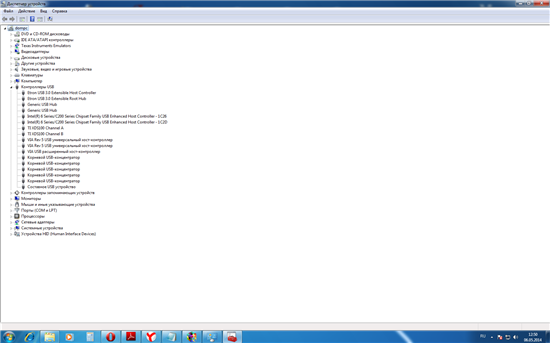

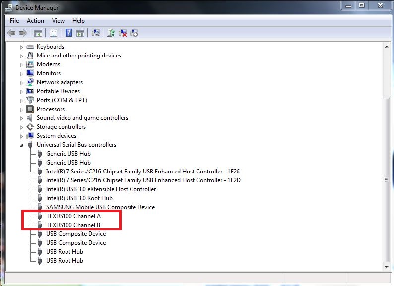

Are you sure that your emulator is XDS100v1 and not XDS100v2 ?

Yup, there is a possibility that the devices might've got permanently locked. If they had not been, you should've been able to unlock them using Uniflash. But that's not the case!
