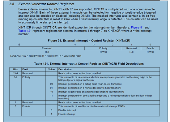

Hi to everybody,
,I have a question about interrupt on dsp28335.
I kow that PIEIER1.bit.INTx5  can set 1 or 0 when I want to use XINT2.
Before I set PIEIER1.bit.INTx5  at 1, I am afraid that signal will occur flag of INTx5 =1.
(because before PIEIER1.bit.INTx5=1, the signal have  been produced)
Can I clear flag of INTx5 by PIEIER1.bit.INTx5=0?
Or have any way can clear flag of INTx5?
I will appreciate your help with this situation.
