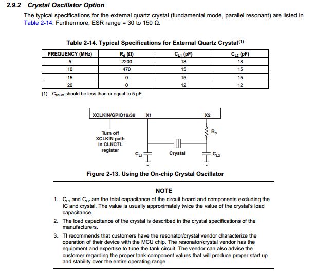

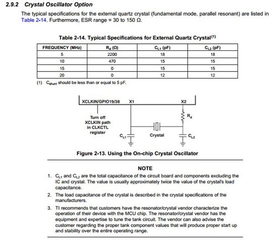

piccolo clock selection
//Using functions from  F2806x_SysCtrl.c , Include correct header file
	XtalOscSel(); //Switches to External CRYSTAL oscillator and turns off all other clock
	//PLL freq =  CLK /2
	InitPll(8, 2);
	//LSPCLK/Low Speed Clock = SYSCLKOUT/(LOSPCPx2) = 20Mhz/(001x2) = 10Mhz
	SysCtrlRegs.LOSPCP.all = 0x0001;
I'm using the f28069 with a 20 MHz crystal oscillator,
I have written the following code to set up the clock
But the processor doesn't seem to be running, what am I missing
Please help
Abhay
