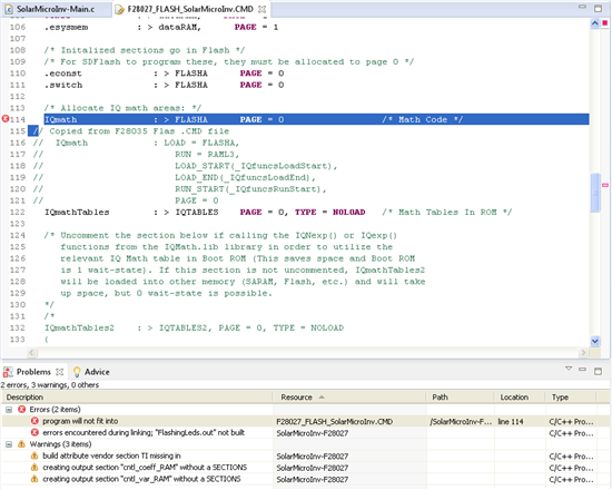

I tried changing the device from F28035 to F28027 with the TMDSSOLARUINVKIT application from Controlsuite and getting some errors like , 'program will not fit into available memory etc.

Thanks Manish, Attached the FLASH Linker command and error msg along with the modified project file.

Prasana,
Use FLASHC for the followings section
ramfuncs : LOAD = FLASHA,
RUN = progRAM,
Post the console error.. it will have description of exactly which section did not fit and by how much..
When I change the build option to closed loop (3) in settings i encounter error again
available memory. run placement with alignment/blocking fails for section
"ramfuncs" size 0x8d0 page 0. Available memory ranges:
progRAM size: 0x800 unused: 0x800 max hole: 0x800
Prasanna,
you can modify the following
progRAM : origin = 0x008000, length = 0x000900
dataRAM : origin = 0x008900, length = 0x000700
hopefully it will work..
