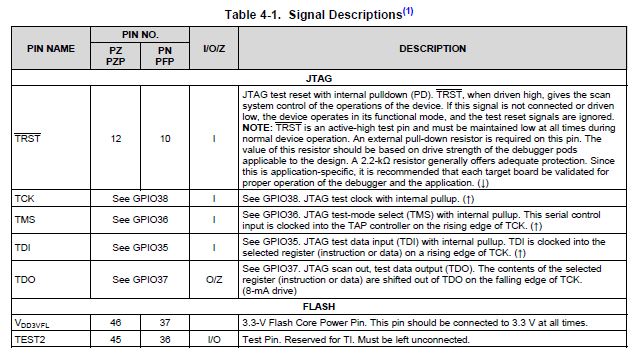

    Per the device datasheet sprs698e, Table 4-1, you normally should have a 2.2K pulldown on TRSTn.
    The device connections should look like this:
    If you have a second emulator, try that to rule out the emulator.  Alternately, if you have a TI EVM board, use the emulator to connect to that, again to rule out the emulator.

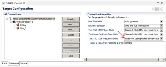

    Try slowing down the JTAG clock in CCS and see if that helps.  Modify the CCS target configuration:
    The default clock for xds100v2 and xds100v3 is 1 MHz (which is already pretty slow from the standard 10 MHz JTAG clock for XDS510 class emulators, but you never know).  I don't think this is going to help, but it is worth trying.
    - David
