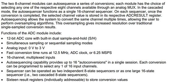

In one of the documents found on TI website i found that ADC in F28335 is SEQ and on F28069 is SOC:
I read the technical documents for both but I still Can't make out the difference.Is there any?If then what is it?

    I know that .I am particularly asking the difference between ADC's of both and why it has been specifically menetion SEQ based for 28335 and SOC based for 28069.
    Ok...
    F28335 has a special sequencer that has a auto-sequencing capability.
    This facility is not available in F28069. Read the below data for F28069:

  • Hi Sneha,
    The F28335 ADC can be configured for 1 sequence of up to 16 conversions or 2 sequences of up to 8 conversions each.  The first sequencer can be triggered by ePWMA or an external pin and the second sequencer can be triggered by ePWMB (the combined sequencer can be triggered by all 3 sources). The S+H window duration can be configured globally to the ADC for all conversions.
    The ADC for 'Piccolo' series devices (including F28069) has 16 individual SOCs.  Each SOC can be configured for a different trigger source (each of the 3 CPU timers, ePWM A or B from each of the ePWM modules, or an external pin) and each can be configured for a different S+H duration.  The 16 SOCs can be combined into any number of individual sequences by using the same trigger source for multiple SOCs.
    In most cases, the SOC based sequencer is more flexible and powerful, but there are some sampling schemes that work better on the F28335 style sequencer.
