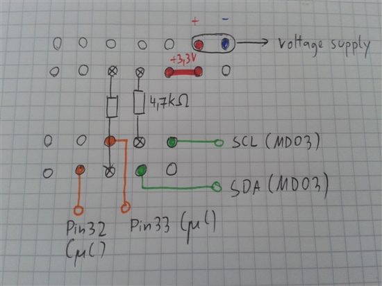

Maybe my connections are the problem. Therefore I want to mention how i connected the MD03 with my µC and the DC motor.
For the connection between the MD03 and the µC I'm using a Breadboard and external voltage supply (+3,3V) and 2 Pull-Up Resistors with 4,7kOhm.
The MD03 is connected to an external voltage supply for the logic (+5V) and a 12V battery for the motor supply.
The connection of the Breadboard looks like this:
I connected the external voltage supply (3,3V) with the + and - wire of my breadboard. Than I connected the + wire with the wire where my Pull-Up resistors are connected.
My resistors are connected to the SDA and SCL wire of the µC (orange line to Pin 32 and Pin 33) and the MD03 (green lines in the Input of MD03 SDA and SCL).
My motor is connected to the both MOT inputs of the MD03.
While debugging I also found that the input of the SDA and SCL wire of the MD03 have a constant voltage level of 3,3V up to line 78.
In this line is the SDA wire on a voltage level of 3,7V and SCL wire on 2,9V. Both levels are constant. I looked at this wires with an oscilloscope and these levels are constant all the time so there are no high and low levels.
The only difference is after executing line 76 the change from 3,3V on SDA and SCL wire to 3,7V on SDA and 2,9V on SCL.

  • André,
    I haven't had a chance to try your code, but I do see a couple problems.
    First, when you poll for a status change, you should poll the I2CSTR register. I2CIER is the interrupt enable register. Its bits do not change unless you write to them.
    Second, you shouldn't be able to get 3.7V on SDA if you're pulling it up to 3.3V. Please check your connections carefully to make sure you're not connecting any 5V signals to the MCU.
