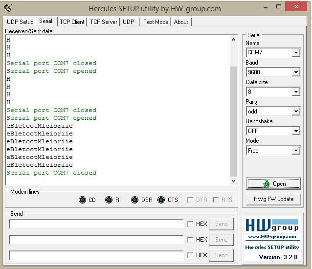

Problem in Configuring Bluetooth Module HC-05 with TMS320F28335
Other Parts Discussed in Thread: TMS320F28335
I connected the Bluetooth Module With SCIRX(28) and SCITX(29) pinsof my TMS320F28335 and transferring a message to the HERCULES terminal using 8 character bits, idle mode,1stop bit,odd parity. The Original message i want to transmit is ''The Bluetooth Module is working Fine''.
But I can see only eBletootheiorle in the Hercules terminal.
C code i used
#include "DSP2833x_Device.h"
// External Function prototypes
extern void InitSysCtrl(void);
extern void InitPieCtrl(void);
extern void InitPieVectTable(void);
extern void InitCpuTimers(void);
extern void ConfigCpuTimer(struct CPUTIMER_VARS *, float, float);
// Prototype statements for functions found within this file.
void Gpio_select(void);
void SCIA_init(void);
interrupt void cpu_timer0_isr(void); // Prototype for Timer 0 Interrupt Service Routine
//                                       main code
void main(void)
       char message[]={"The Bluetooth MOdule is Working Fine \n\r"};
       unsigned int index =0;     // pointer into string
       InitSysCtrl();       // Basic Core Initialization
                                  // SYSCLK=150MHz, HISPCLK= 75MHz, LSPCLK=37.5MHz
       EALLOW;
       SysCtrlRegs.WDCR= 0x00AF;         // Re-enable the watchdog
       EDIS;                // 0x00E8 to disable the Watchdog , Prescaler = 1
                                  // 0x00AF to NOT disable the Watchdog, Prescaler = 64
       Gpio_select();       // GPIO9, GPIO11, GPIO34 and GPIO49 as output
                                  // to 4 LEDs at Peripheral Explorer
       SCIA_init(); // Initalize SCI
       InitPieCtrl();       // default status of PIE; in DSP2833x_PieCtrl.c
       InitPieVectTable(); // init PIE vector table; in DSP2833x_PieVect.c
       // re-map PIE - entry for Timer 0 Interrupt
       EALLOW;
       PieVectTable.TINT0 = &cpu_timer0_isr;
       EDIS;
       InitCpuTimers();     // Function in: DSP2833x_CpuTimers.c
       // Configure CPU-Timer 0 to interrupt every 50 ms:
       // 150MHz CPU Freq, 50000 µseconds interrupt period
   ConfigCpuTimer(&CpuTimer0, 150, 50000);     // DSP2833x_CpuTimers.c
       // Enable TINT0 in the PIE: Group 1 interrupt 7
       PieCtrlRegs.PIEIER1.bit.INTx7 = 1;
       // Enable CPU INT1 which is connected to CPU-Timer 0:
   IER = 1;
       // Enable global Interrupts and higher priority real-time debug events:
       EINT;   // Enable Global interrupt INTM
       ERTM;   // Enable Global realtime interrupt DBGM
       CpuTimer0Regs.TCR.bit.TSS = 0;           // Start T0
       while(1)
            SciaRegs.SCITXBUF=message[index++];                    // send single character
             while ( SciaRegs.SCICTL2.bit.TXEMPTY == 0); //wait for TX -empty
              if (message[index]== '\0')                                    // test '\0' end of string
                     index =0;
             while(CpuTimer0.InterruptCount < 40)    // 40 * 50ms = 2 sec
                           EALLOW;
                           SysCtrlRegs.WDKEY = 0xAA;                // Service watchdog #2
                           EDIS;
                     CpuTimer0.InterruptCount = 0;
       EALLOW;
       GpioCtrlRegs.GPAPUD.bit.GPIO28=1;       // Enable pull-up for GPIO28 (SCIRXDA)
       GpioCtrlRegs.GPAPUD.bit.GPIO29=1;       // Enable pull-up for GPIO29 (SCITXDA)
       GpioCtrlRegs.GPAMUX1.all = 0;                   // GPIO15 ... GPIO0 = General Puropse I/O
       GpioCtrlRegs.GPAMUX2.all = 0;                   // GPIO31 ... GPIO16 = General Purpose I/O
       GpioCtrlRegs.GPAMUX2.bit.GPIO28 = 1;     // SCIRXDA
       GpioCtrlRegs.GPAMUX2.bit.GPIO29 = 1;     // SCITXDA
       GpioCtrlRegs.GPBMUX1.all = 0;                   // GPIO47 ... GPIO32 = General Purpose I/O
       GpioCtrlRegs.GPBMUX2.all = 0;                   // GPIO63 ... GPIO48 = General Purpose I/O
       GpioCtrlRegs.GPCMUX1.all = 0;                   // GPIO79 ... GPIO64 = General Purpose I/O
       GpioCtrlRegs.GPCMUX2.all = 0;                   // GPIO87 ... GPIO80 = General Purpose I/O
       GpioCtrlRegs.GPADIR.all = 0;
       //GpioCtrlRegs.GPADIR.bit.GPIO9 = 1;            // peripheral explorer: LED LD1 at GPIO9
       //GpioCtrlRegs.GPADIR.bit.GPIO11 = 1;           // peripheral explorer: LED LD2 at GPIO11
       GpioCtrlRegs.GPBDIR.all = 0;                    // GPIO63-32 as inputs
       GpioCtrlRegs.GPBDIR.bit.GPIO34 = 1;      // peripheral explorer: LED LD3 at GPIO34
       GpioCtrlRegs.GPADIR.bit.GPIO31 = 1; // peripheral explorer: LED LD4 at GPIO49
       GpioCtrlRegs.GPCDIR.all = 0;                    // GPIO87-64 as inputs
       EDIS;
void SCIA_init()
       SciaRegs.SCICCR.all =0x0027;      // 1 stop bit, No loopback
                                         // ODD parity,8 char bits,
                                         // async mode, idle-line protocol
       SciaRegs.SCICTL1.all =0x0003;    // enable TX, RX, internal SCICLK,
                                        // Disable RX ERR, SLEEP, TXWAKE
       // SYSCLOCKOUT = 150MHz; LSPCLK = 1/4 = 37.5 MHz
       // BRR = (LSPCLK / (9600 x 8)) -1
       // BRR = 487 gives 9605 Baud
       SciaRegs.SCIHBAUD   = 487 >> 8;         // Highbyte
       SciaRegs.SCILBAUD   = 487 & 0x00FF;     // Lowbyte
       SciaRegs.SCICTL1.all = 0x0023;    // Relinquish SCI from Reset
   CpuTimer0.InterruptCount++;          // increment time counter
       GpioDataRegs.GPBTOGGLE.bit.GPIO34 = 1; // toggle LED at GPIO34
       // Service the watchdog every Timer 0 interrupt
       EALLOW;
       SysCtrlRegs.WDKEY = 0x55;         // Service watchdog #1
       EDIS;
       // Acknowledge this interrupt to receive more interrupts from group 1
       PieCtrlRegs.PIEACK.all = PIEACK_GROUP1;
// End of Source Code.
