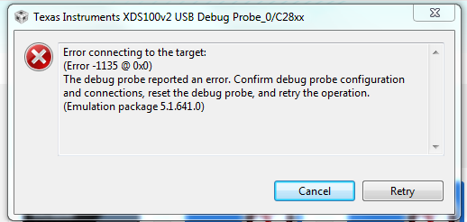

  • Yes I stumbled upon this thread earlier today but now I am stuck trying to flash code to the board and run the debugger. I am getting the following error when I run the Target Config Test Connection

    The following error is what I get when I try to debug the program:
  • First of all close this thread... as you've new issue for which you've already opened a new thread.
    Will assist you in another thread.
    Goodluck & Regards,
    Gautam
