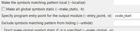

    "code_start" is defined in the file "F2837xD_CodeStartBranch.asm" and "F28x_usDelay" is located in "F2837xD_usDelay.asm". Check your included headers and files for any duplication of those files or function names since that is what error #10056 indicates.
    Also, make sure to check that your entry point "code_start" is set under project properties. (Project Properties->Build->C2000 Linker->Advanced Options->Symbol Management)
    Let me know if that helps!
