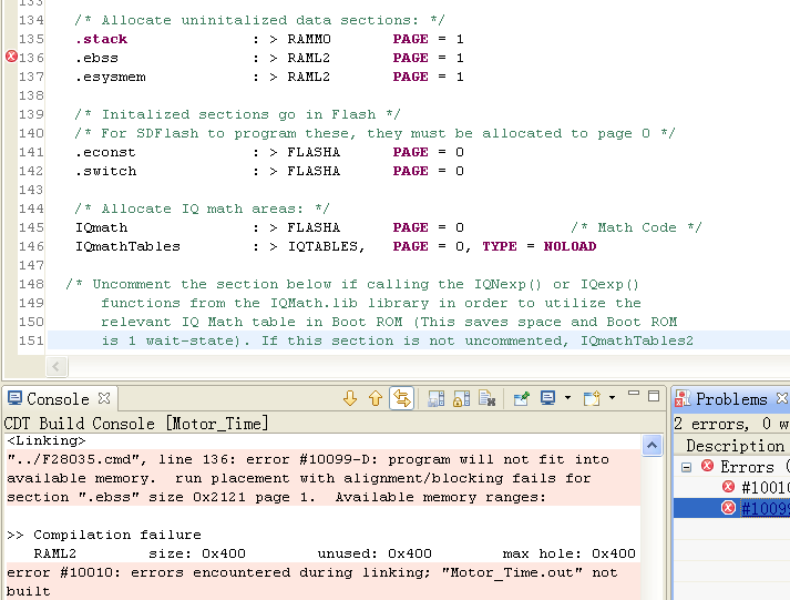

error 'ebss' program will not fit into available memory
Is this original example from controlsuite? Or have you modified something on the example?
You can choose to use flash mode instead of ram mode, because flash size is bigger than ram.
