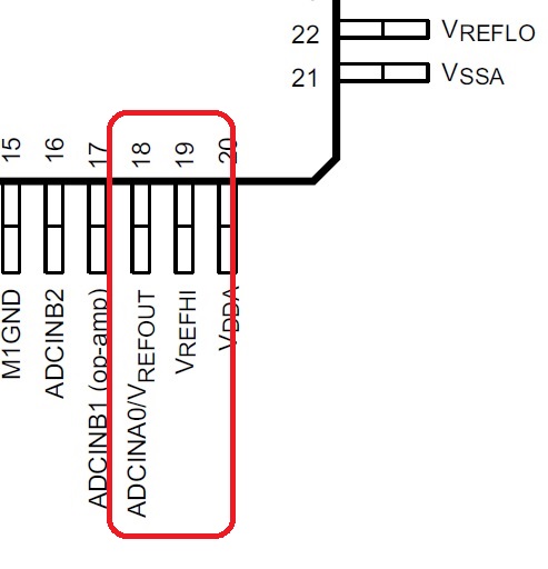

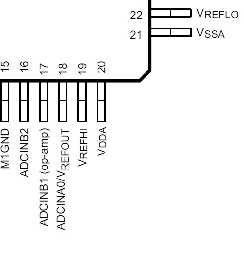

Hi there,
The TMS320F2805x datasheet says Vrefout is p18 and shared pin with ADCINA0 and VREFHI is p19, but the TRM says ADCINA0 is shared with VREFHI. Can someone please clarify this confusion? thank you
regards,
Kevin
Hi Kevin,
The DS is correct and the TRM has a typo. Thanks for bringing this to our attention, I'll submit a change request to the TRM.
Joe
