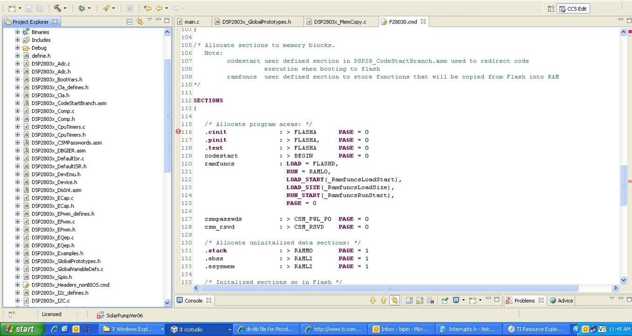

Thank You sir,
I am facing another Problem i just started the to develop the firmware using the base example.every time i got below error. please give remedy for that
line 48: error #10099-D: program will not fit into available
memory. placement with alignment fails for section ".text" size 0x2b12 .
Available memory ranges:
FLASH size: 0x1000 unused: 0xe56 max hole: 0xe56
Linker File :-- F28030.cmd
Stack Size :- 800
Heap Size :- 800

cmd file seems to be fine. Some issue with your code or headers. I hope you use the Project -> Import Project option to import an example file. I'm asking you this question because I'm able to see all the peripheral header and source files attached to your project even though only couple are required for led_blinky example.
