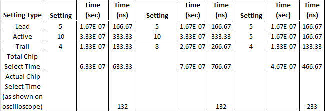

I have not been able to reliably read and write to a flash chip using the XINTF (16-bus).
The code is attached and is a a modified version of the Example_2833xDMA_xintf_to_ram (i.e. example from control suit). I am using the XDS100v2 debugger to debug the code.
I believe one of the issues is the the flash chip select low time.  The flash chip select is only staying low for approximately 40ns, which is significantly less than what it should be as specified by the following settings (from code):
    XintfRegs.XTIMING7.bit.XWRLEAD = 5;
    XintfRegs.XTIMING7.bit.XWRACTIVE = 12;
    XintfRegs.XTIMING7.bit.XWRTRAIL = 4;
    // Zone read timing
    XintfRegs.XTIMING7.bit.XRDLEAD = 5;
    XintfRegs.XTIMING7.bit.XRDACTIVE = 12;
    XintfRegs.XTIMING7.bit.XRDTRAIL = 4;
Could someone at TI please verify the code is working properly.

  • Hi Stephen,
    Did you check the time wrt no of XCLKOUT cycles? In another post you mentioned that XCLKOUT has some impact on the XINTF signal. Is this same setup or different one?
    Vivek Singh
  • Hello Vivek,
    It's the same setup.
    The number of XCLKOUT cycles  times the XCLKOUT frequency is matching the amount of time the chip select is low.
    The problem is that the chip select low time doesn't match the lead/active/trail setting.
    Also, I decreased the active setting value by 1/2 for both read and write  (from 12 to 6) and the chip select low time went from 40ns to 51ns, which is odd since it should decrease and not increase.
    Stephen
  • Hello Vivek,
    I reduced the SYSCLK to 30MHz.  The chip select low time for various settings (Both write and read) are shown in the table below.
    Stephen
  • Hello Vivek,
    I failed to completely read the datasheet.  The setting range for lead,active and trail periods are shown below.
    My settings were overflowing the bit field.
    I'll try some correct settings and then get back with you with the results.
    Stephen
    XRDLEAD: 0 to 3.
    XRDACTIVE:  0 to 7
    XRDTRAIL: 0 to 3
    XWRLEAD: 0 to 3.
    XwRACTIVE:  0 to 7
    XWRTRAIL: 0 to 3
