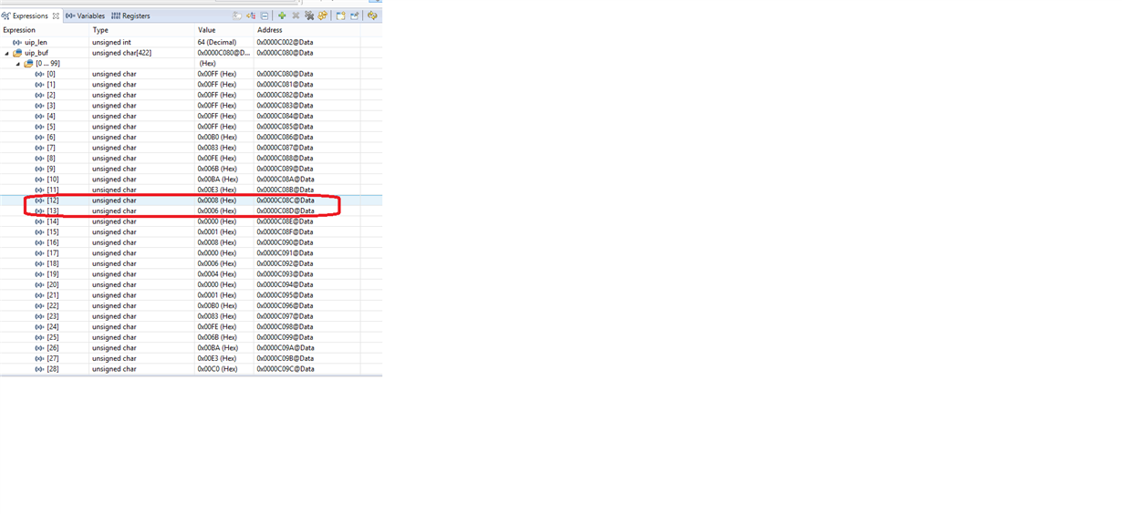

  • Hi Whitney,
    See attachment for memory information of "uip_buf" in detail.
    From memory looks like, Address 0x0000C08C and 0x0000C08D are in sequence without any extra field with data 0x00.
    Kalpesh.
  • Kalpesh,
    That's what I was expecting it to look like. You have to remember that chars are 16 bits on the C2000, so what you have here is:
    00FF 00FF 00FF 00FF 00FF 00FF 00B0 0083 00FE 006B 00BA 00E3 0008 0006
    But the structure we've created is expecting:
    FFFF FFFF FFFF B083 FE6B BAE3 0806
    When you're filling the uip_buf, you could pack it as shown above by shifting every other byte received into the upper 8 bits of the char. Or you could take advantage of the __byte() intrinsic that's described in the compiler user guide. The consequence of this is that you'll have to make modifications to the stack almost anywhere pointer arithmetic or indexing into this buffer is being performed since in this scenario, two bytes have the same address.
    Unfortunately, given that the architecture can't do 8-bit byte addressability, I don't think there's going to be a good way to get around having to make these changes to the stack.
    Whitney
