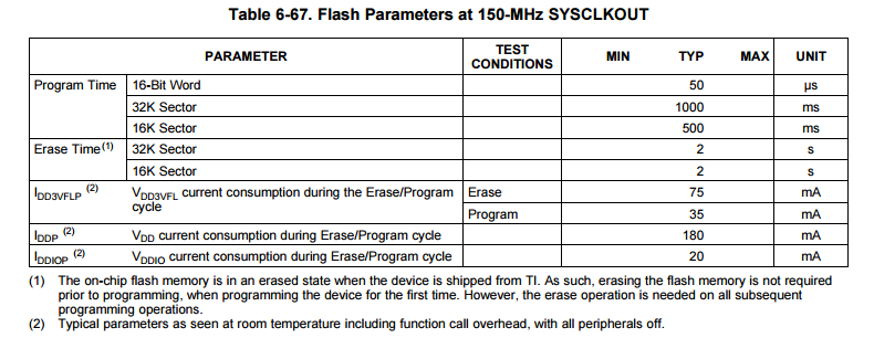

    2. once data storage in SARAM completes, let say 3k word . After this to retain this data i want to transfer to the FLASH. This is not time critical operation as we have plenty time to copy 3K word into FLASH.
    3. Last stage is also not time critical, Just move data from FLASH to PC via SCI/ SPI.
    So is 2nd and 3rd stages are possible via FLASH API ? if so How much time FLASH can take in 2nd stage to write 3k Word? could you please suggest some piece of code if available to understand how it will work?

  • Hi Pritesh,
    The flash write timings can be found in the datasheet here:
    I am not sure why the flash writes won't be in the critical path if you want to sample for 2s continuously.  It only takes about 300us to fill up 3Kx16 of RAM with ADC samples, but it is going to take 100ms to program the same data into flash?  I think you will want to use an external ram with XINTF to save the data.
