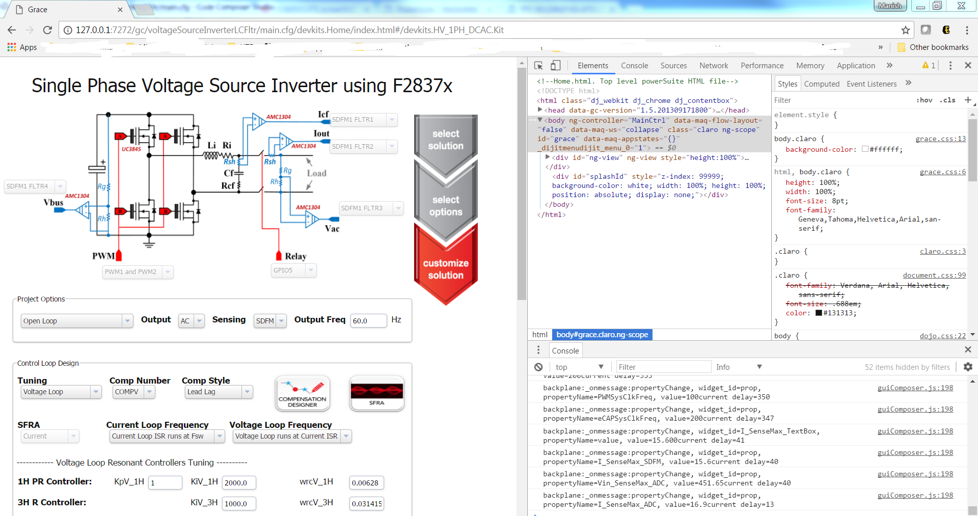

Hello, TI Experts,
Our customer sent us a question about Power Suite with Out of the box demo(Buck_VMC_F28069M).
Question:
  We cannot see any GUI view on CCS like below from TI video. (please see page1 and page2  of attatched pdf)
http://link.brightcove.com/services/player/bcpid3917207363001?bckey=AQ~~,AAADeK19QZE~,BDUED4gHjR8HLl1b_DFhPB4WG3B025_s&bctid=4107345616001
 How do we solve this problem?
We found the related E2E thread as below.
 http://e2e.ti.com/support/development_tools/code_composer_studio/f/81/p/577599/2121050?tisearch=e2e-sitesearch&keymatch=power%20suite#2121050
This E2E thread said "check FAQ" so we also checked FAQ and CCS installed software.
->Please also see page3-7 of attatched pdf as FAQ checked result.
We would appreciate if you tell us how to solve this problem.
Best regards,power_suite_capt.pdf

    Thank you for your detailed explanation.
    I really appreciate your help.
    Yes, we have verified all of the three from your advice.
    Our CCS version and XDC tool version is reported with attatched pdf of previous posted E2E thread.
    Please refer the attatched pdf which includes screen shot of CCS windows.
    And we'd like to send the pdf again and report as below;
      - CCS: 7.1.0.00016
      - XDCtools: 3.31.0.24
      - powerSUITE: 1.7.0.00
      - GUI Composer for CCS: 1.0.0
    This issue seems to be urgent.
    So we'd like to provide the information of TI verified tools combination to the customer.
    We would appreciate if you tell us the TI verified tools combination including CCS, XDCtools, powerSUITE and GUI composer.
    Best regards,6505.power_suite_capt.pdf

    We can find the PowerSUITE GUI with CCS:6.1.3.00033.
    But we cannot find PowerSUITE GUI with CCS: 7.1.0.00016.
    It seems that key difference is "View->GUI Composer" behavior.
    Please refer the attatched pdf.
    8054.prtscr.pdf
    If you have any clue or update, please tell us.
    And I also send the eclipse log file.
    So we also appreciate  if you check the log.

  • Matusan,
    Thanks for your update.
    I don't think it is the GUI Composer issue, because on my machine I am able to see the CFG page but am still not able to click on Applications 1.
    The GUI composer on CCSv7.1 is a new one, so you need the runtime only which is installed per the screen shot provided.
    Unfortunately so far we do not have a root cause of the issue,
    One more thing i would recommend to do is following in CCSv7.1
    1. For debugging the HTML page open CCS , click Windows -> Preferences -> CCS -> Grace and Check 'Enable Grace developer features'
    2. Restart workspace
    3.  Now you will be able to copy the URL from the cfg page for debug in Chrome. Right click on the header bar of the CFG page ,
    4. In chrome go to More Tools -> Developer Tools , and copy paste the URL in the address bar. You can now use this page for debugging the javascript and the HTML file.
    3. now a toolbar will appear and it may display some errors of issues..
    Thank you for your kindness.
    This is good way to analyze.
    I'd like to sent the result of both CCSv6(success case) and CCSv7.1(Fail case).
    Please refer attatched pdf.
    The error log of CCSv7.1 looks same as that of CCSv6.
    (How is the error log of your CCS?)
    We would appreciate if you tell us some clue of this problem.

  • Thanks for trying this,
    I would recommend the following as well,
    1. Check if migrating to CCSv7.2 resolves the issue
    2. In CCSv7.1 ,
    Attached is a test app. Extract the zip file into <ccs_install_dir>\ccsv7\webapps. you should be able to open the app from CCS menu View->GUI Composer->Applications v1.
    TestApp.zip
    and report back, this will help us ensure Gui Composer install is correct..
    3. Also in the attached, i am not sure when you copied the URL did you close the CCS ?? you need to keep CCS opened when you copy the URL.
    Manish
    Thank you very much for your kindness.
    I tried those 3 instructions from you.
    The results are as follows;
    1:
      CCSv7.2(7.2.0.00013) don't resolves the issue.
      (We cannot see any GUI view on CCS)
    2:
      We can find "TestApp"-GUI on both CCSv7.1 and CCSv7.2.
      (Please refer attached pdf.)
    3:
       Yes! CCS is kept opened, when we copy the URL for main.cfg of Buck_VMF_F28069M project.
          - I tried again with both CCSv7.1 and CCSv7.2.
          - The result(Error message in Chrome developer tools ) seems to be same.
       But in the attached "Testapp", I cannot copy the URL near TestApp tab in CCS.
    TestApp.pdf

  • did you check Gui Composer Runtime Install ?
    go to view-> CCS App center -> GUI Composer Runtime v1
  • Hi Manish,
    I hope you are safe in hurricane.
    if this problem is only occur in Japan/Korea, it could be backslash conversion problem. these countries uses different backslash symbol. please check with backslash conversion.
    as I see, all of my korean customers can't use powersuite.
    this is from wikipedia.
    Confusion in usage[edit]
    In the Japanese encodings ISO 646 (a 7-bit code based on ASCII), JIS X 0201 (an 8-bit code), and Shift JIS (a multi-byte encoding which is 8-bit for ASCII), the code point 0x5C that would be used for backslash in ASCII is instead rendered as a yen mark (¥), while in Korean encoding, it is drawn as a won currency symbol (₩). Computer programs still treat the code as a backslash in these environments, causing confusion, especially in MS-DOS filenames.[20] Due to extensive use of the backslash code point to represent the yen mark, even today some Unicode fonts like MS Mincho render the backslash character as a ¥, so the Unicode characters 00A5 (¥) and 005C (\) look identical when these fonts are selected. Several other ISO 646 versions also replace backslash with characters like Ö (German, Swedish), Ø (Danish, Norwegian), ç (French) and Ñ (Spanish), leading to similar problems. Since the character was originally not available in all character sets and keyboard layouts, ANSI C can transcribe it in form of the trigraph ??/ which, outside string literals, is equivalent to the \ character. RFC 1345 recommends to transcribe the character as digraph //, if not available.
    Ted
  • Hi all,
    If your windows is not using / having "English (United States)" Language pack, Please install it and set it as a default language.
    In my machine and customer's machine, by this method, we were able to run PowerSuite.
    We used Windows 10, CCSv7.1.0 and v7.2.0, and GUI Composer Runtime is installed.
    Maybe CCS/Powersuite guys will fix this problem at next version.
    Ted
  • Ted thanks for the insight.
    I am not sure how we fix it , but we will discuss with the team how it can be resolved in future.
    regards
    Manish Bhardwaj
