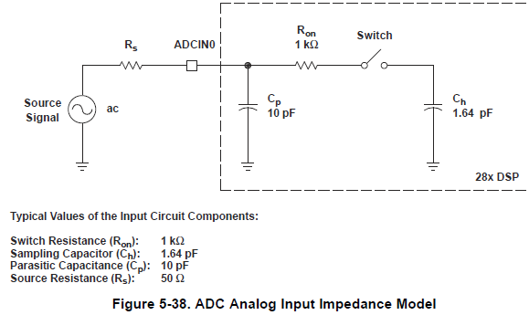

    1b. Unlike in 1a where I had just connected ADCLO through a 10ohm resistor, I decided to use the RC this time. And I grounded the C through AGND (1 kohm resistor + ground) to a the ground of a power supply at 0v. I got the following [11,37,29,0,0...] and [0,12,16,8,0...]. It seems the ground has messed it up somehow. Anyway, what do you think or have I carried out the test wrongly?
    You should be sampling ADCLO directly with no resistance.  There is a Sampling Capacitor (Ch) that must be charged (or discharged) to the ADCIN voltage within the ACQ_PS sampling window.  Adding series resistance (Rs) will slow down the charging speed:

    David Bamgboje said:
    By the way, I am not really using the diagram you pasted, I am using the one with the op-amp and that one has Rin and Cin so If i put together what you said about not sampling ADCLO through a resistor which in my case is RIN, do you mean I should only use the Rin&Cin for analogue inputs not for ADCLO sampling test. If so, I will do that but I am still left with the conversion issue........
    The diagram is the ADC Input Impedance Model from the datasheet.  It is meant for the user to understand the electrical characteristics of the ADC input pin.  For example, you can run SPICE simulations using that model to calculate the required ACQ_PS value for your system.
