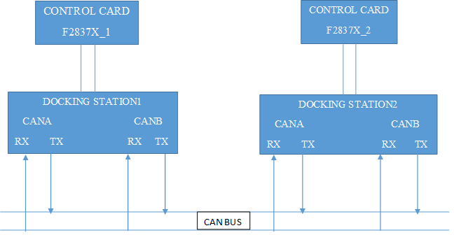

But to surprise no data is getting stored in AdcaResults variable. Can anyone suggest the missing command in the above source code.
Thanks in advance.
Sumanta
  • Hi Sumanta,
    Does this work with the unchanged example from ControlSUITE? If not, you should focus on HW debug like checking the channel connections, supply rails, ADC reference, etc. If it does work unchanged, go back to that code and make one change at a time and verify correct operation at each step.
  • Hi Devin,
    Thanks for your response. I am using the ADC channel (ADCINA2) and accordingly configured in my source code. I would like to know what changes are you suggesting to do in the program or any other ADC program that can be debugged and checked for storing data from ADC analog input to ADC registers.
    Thanks in advance.
    Sumanta
  • Hi Sumanta,
    I think by default the example is set to convert on channel A0 by default? Try to get that to work before making changes to the stock example. If you can't get that to work, the issue is probably HW/Setup related (e.g. VDDA suppy rail is not correct, VREF pin is not supplied, input stimulus is hooked up to the wrong header and/or pin, etc.). If A0 works but not A2, then you should carefully consider what SW changes you have made to determine if they are correct/complete.
  • Hi Devin,
    Can you tell me in the above source code what will be the corresponding configuration settings for channel ADCINA2 so that ADC outputs getting stored in register can be obtained in Code Composer Studio window environment. Please suggest.
    Thanks in advance.
    Sumanta
  • Hi Devin,
    The modified source code is as below:
    // Included Files
    #include "F28x_Project.h"
    #include <stdint.h>
    #include <stdbool.h>
    #include "inc/hw_types.h"
    #include "inc/hw_memmap.h"
    #include "inc/hw_can.h"
    #include "driverlib/can.h"
    // Function Prototypes
    void ConfigureADC(void);
    void ConfigureEPWM(void);
    void SetupADCEpwm(Uint16 channel);
    interrupt void adca1_isr(void);
    // Defines
    #define RESULTS_BUFFER_SIZE 8
    // Globals
    volatile unsigned long g_ulMsgCount = 0; // A counter that keeps track of the
    // number of times the transmit was
    // successful.
    volatile unsigned long g_bErrFlag = 0; // A flag to indicate that some
    // transmission error occurred.
    Uint16 AdcaResults[RESULTS_BUFFER_SIZE];
    Uint16 resultsIndex;
    volatile Uint16 bufferFull;
    // Main
    void main(void)
    tCANMsgObject sTXCANMessage;
    tCANMsgObject sRXCANMessage;
    unsigned char ucTXMsgData[8]={'0','0','0','0','0','0','0','0'}, ucRXMsgData[8]={'0','0','0','0','0','0','0','0'};
    // Step 1. Initialize System Control:
    // PLL, WatchDog, enable Peripheral Clocks
    // This example function is found in the F2837xD_SysCtrl.c file.
    InitSysCtrl();
    // Step 2. Initialize GPIO:8
    // This example function is found in the F2837xD_Gpio.c file and
    // illustrates how to set the GPIO to its default state.
    InitGpio();
    GPIO_SetupPinMux(36, GPIO_MUX_CPU1, 6); //GPIO30 - CANRXA
    GPIO_SetupPinMux(37, GPIO_MUX_CPU1, 6); //GPIO31 - CANTXA
    GPIO_SetupPinOptions(36, GPIO_INPUT, GPIO_ASYNC);
    GPIO_SetupPinOptions(37, GPIO_OUTPUT, GPIO_PUSHPULL);
    // Initialize the CAN controller
    CANInit(CANA_BASE);
    // Setup CAN to be clocked off the M3/Master subsystem clock
    CANClkSourceSelect(CANA_BASE, 0);
    // Set up the bit rate for the CAN bus. This function sets up the CAN
    // bus timing for a nominal configuration. You can achieve more control
    // over the CAN bus timing by using the function CANBitTimingSet() instead
    // of this one, if needed.
    // In this example, the CAN bus is set to 500 kHz. In the function below,
    // the call to SysCtlClockGet() is used to determine the clock rate that
    // is used for clocking the CAN peripheral. This can be replaced with a
    // fixed value if you know the value of the system clock, saving the extra
    // function call. For some parts, the CAN peripheral is clocked by a fixed
    // 8 MHz regardless of the system clock in which case the call to
    // SysCtlClockGet() should be replaced with 8000000. Consult the data
    // sheet for more information about CAN peripheral clocking.
    CANBitRateSet(CANA_BASE, 200000000, 500000);

                    I will explain the problem which I am facing presently reg. data transmission between 2 MCUs.
    1) In MCU1, data is getting sensed from ADCIN port and is being stored in Transmitter (TX) register of CAN port.
    2) From (TX) register, data is getting transferred which should be received by Receiver (RX) register of MCU2.
    The block diagram of operation is as shown in the Attachment figure:
    On debugging the program data is getting sensed in ADC register which is getting stored in TX register in MCU1. But MCU2 RX register is not able to retrieve the same data. It is sensing data whenever the ADCIN of MCU2 is given external inputs.
    Is it reqd. to configure the ADC of MCU2 separately to receive the data and finally to check the DAC output which will be same as the ADC Input.
    Please suggest.
    Thanks in advance.
    Sumanta

    Looks like you are able to convert on MCU1 but cannot transmit the conversion result to MCU2. The issue you are facing is not a ADC or DAC problem and more of a CAN transmission problem. Please look at the CAN examples in C2000Ware to familiarize yourself with how the CAN operates and if you ran into any issues with those, you can post the CAN question separately and the right CAN expert will address those questions.
  • Hi Frank,
                     As you have correctly understood, presently data transmission between 2 MCU cards are being carried out through CAN port of DSP via
    CAN bus. I will explain regarding the task which I want to perform and the difficulty which I am facing at present:
    1) In case of any fault in converter input data (message) will get sensed through ADC port of MCU1 which will be transmitted to MCU2 via CAN
        mechanism.
    2) Once the MCU2 has received the data it will send signal to the auxillary ports (say DAC, QEP or PWM) to perform a particular operation (say
        blinking an LED indicating fault or turning off the PWM signal).
    So now I am trying to generate an event (say changing Vin of ADC channel from 0 to +3.3V), storing the corresponding data in ADC register of
    MCU1 and sending the same to MCU2 which in turn will blink an LED.
    Please suggest any idea for its implementation in the source code.
    Thanks in advance.
    Sumanta

                      I am attaching the Block diagram of my present work on CAN communication between 2 control cards.
    So as I mentioned in my previous post, the source code in CCS Studio is successfully tested with two CAN ports (i.e CANA and CANB) of CONTROL CARD1 or with CONTROL CARD2, but the same operation is not getting executed with similar CAN PORTS (i.e CANA for CONTROL CARD1 and CANB for CONTROL CARD2. So I was asking you suggestions if similar problem has been faced by you for CAN data transmission.
    Sumanta
  • Hi Sumanta,
    Thanks for providing the block diagram of your system. Sorry, maybe you have answered this question before but I still am not sure where the CAN transceivers are located. The F2837X Control Cards do not have built in CAN transceivers and the control card docking station (latest rev 4.1) does not have transceivers as well. Did you install CAN transceivers in your docking station or do you have custom docking station that has transceivers for each of the CAN modules?
    Joseph
  • Hi Joseph,
                       I have not specified regarding the CAN transceiver but in my system setup already Transceivers are fixed in separate PCBs which are connected to form the CAN Bus. So with similar architecture as mentioned in my previous post I have tested between 2 CAN PORTS of each CONTROL card and similar CAN PORTS each from individual CONTROL card where the problem in data transmission is observed. Please suggest.
    Sumanta
  • Hi Sumanta,
    Ok, thank you for confirming your setup.  Do you have visibility on the CAN registers, specifically CAN_ES (Error and Status Register)?  Can you let me know what you read from this register on the transmitting node as well as with the receiving end?  This would tell us a lot about what is going on with your setup.
    Thanks and regards,
    Joseph

  • Hi Sumanta,
    Not sure if your issues have been resolved with ADC conversions and CAN data transmission.  Let me know if you still need some guidance.  I did not see any response based from Frank's feedback so I am just checking back with you.
    Joseph
  • Hi Sumanta,
    The bus-off state is a good indication why you cannot get data to transmit/receive via the CAN bus. You need to debug your application to see when the bus-off bit gets set. There is a feature in the CAN module that will allow the CAN to recover from bus-off state automatically. This feature is accomplished by setting the ABO bit in the CAN_CTL register (bit 9). Try setting this bit in your application code on both cards to see if this solves your problem.
    Joseph
  • Hi Sumanta,
    I think this post relates to the one I responded to earlier about the bus-off bit being set. There is more indication from this post that CANB is probably not initialized the fact that you are seeing values of 0 on the CANB registers. I am assuming the CANB is the module you are using on the second card and CANA if from the first card.
    On the second card, make sure that all these statements are executed:
    - GPIO mapping for CANB (make sure the correct GPIO channels are used and are actually connected to the transceiver)
    - CANInit(CANB_BASE); CANClkSourceSelect(CANB_BASE); CANBitRateSet(CANB_BASE, your_system_speed, your_baud_rate); CANIntEnable (for CANB if you decide to use interrupts when messages are received and of course add the interrupt definitions and ISRs)
    Once you have confirmed the above statements are executed on the second card, read back the CANB register values again and confirm if the registers still contain 0's. Do these steps first to ensure that CAN B on the 2ns card is indeed being configured correctly first.
    Joseph
