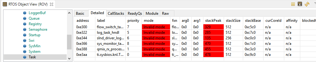

There are some screen shots below that show the code initially connecting to the debugger and starting at main, stepping through the initial main C code and then reaching BIOS_start() and the code going off in the weeds for some reason.

    Do no breakpoints in tasks or Hwis get hit at all? The location that the code jumped to (at address 0x3ff9fa) is the illegal instruction handler in boot ROM. Are you able to step into BIOS_start() at all to get an idea of where it's happening?

    No, the breakpoints are never hit. During debug, in ROV, under Task, the mode is 'invalid mode' and I'm not sure what caused that. Please refer the screenshots. Thank you.
  • Anjali,
    A few questions:
    1. Where was the PC when you paused and took those ROV shots above with "Invalid mode" shown? I assume that was right after the exception where BIOS exited.
    2. Have you tried adding 50% stack size to each Task stack (one at a time) and rebuilding/running to see if that makes a difference?
    3. How many functions do you have in Idle? Idle has its own stack, so include that in your "more stack" exercise above.
    4. If you set a breakpoint in the prologue (before the while loop) of the highest Pri Task (sys_monitor_...) (which should run first right after BIOS_start() ), you are saying you NEVER get to that breakpoint?
    5. When you single step into BIOS_start() (not step over), is there any indication of WHICH instruction is executing when the exception is thrown? The address 0x3F_FFC0 is the beginning of the boot rom vector table. This is enabled if VMAP=1, disabled if ENPIE = 0. Not sure if that has any bearing. But the address indicated in the error is "0xFFFF_FFFF_FFFF_FFC0" which is WAY out side of this memory map.
