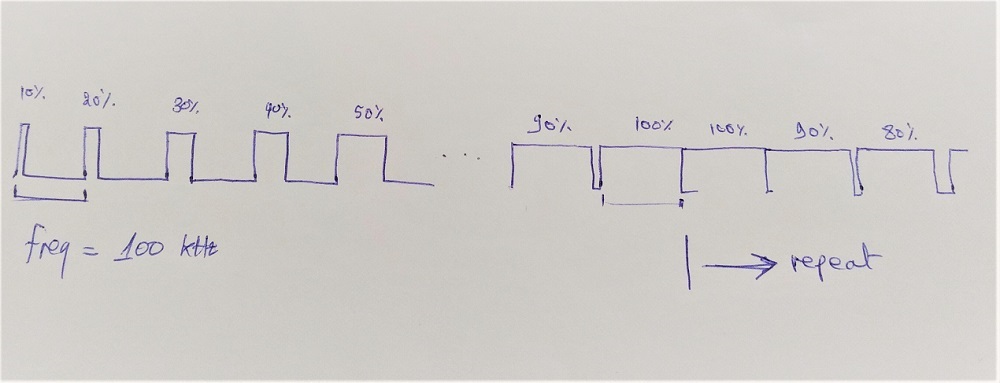

I wanna generate the following signal using LAUNCHXL-F28379D. Is there a way to configure ePWM to change the duty cycle in each period (like 10%, 20%, ...., 90%, 100% and then 100%, 90%,....., 10%) and then repeat the process again and again?

  • I used the example you provided me and the ISR worked fine but  the dutycycle doesn't change tho because of updown count. So i tried to change the count mode to UP but the code doesn't enter ISR at all, what did i do wrong !?

    I don't know what's wrong with this code!? is it (EPwm1Regs.ETSEL.bit.INTSEL = 1; //2 3 4 5) because i tried all possibilities ?
  • Please ACK the correct group in the ISR.
        // Acknowledge this interrupt to receive more interrupts from group 3
        PieCtrlRegs.PIEACK.all = PIEACK_GROUP3;
    You are ACKING GROUP 1.
  • Also enable the correct ACK group.
    PIEIER3 not IER1
  • Thanks,
    when i used PIE Group 3, code works fine.
    i understand from your answer that epwm interrupt works only with group 3 !!
