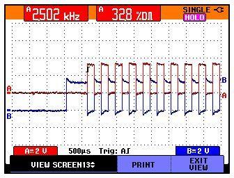

I am using TMS320F28069F controller in my board. I implemented example code lab02a. I observed first pulse of PWM during CTRL_State_OffLine and EST_State_Idle (Hardware Offsets Calibrated) stage is more than 50% duty cycle (as mention in spruhj1b, 6.5.2). Because of this passed more current from AC motor. Here some snap in oscilloscope for better understanding.
Can anyone know why this happen? Or something I missed in my code.

  • The issue was that the structure gPwmData is initialized after reset, but it is never initialized to zero after running and stopping the motor. So for example, if the motor is running and you stop, then gPwmData will have values that aren't zero. Next time you call the function HAL_enablePwm() the values already written in the PWM double buffers will be outputted on the PWM pins. The solution is this. Change your HAL_disablePwm() function to this:
    static inline void HAL_disablePwm(HAL_Handle handle,HAL_PwmData_t *pPwmData)
      HAL_Obj *obj = (HAL_Obj *)handle;
      PWM_setOneShotTrip(obj->pwmHandle[PWM_Number_1]);
      PWM_setOneShotTrip(obj->pwmHandle[PWM_Number_2]);
      PWM_setOneShotTrip(obj->pwmHandle[PWM_Number_3]);
      pPwmData->Tabc.value[0] = _IQ(0.0);
      pPwmData->Tabc.value[1] = _IQ(0.0);
      pPwmData->Tabc.value[2] = _IQ(0.0);
      return;
    } // end of HAL_disablePwm() function
    And this is how you call it:
    HAL_disablePwm(halHandle, &gPwmData);
    So what's going to happen is that every time you disable PWM outputs, the gPwmData structure will also be initialized to zeros. So next time you call HAL_enablePwm(), the PWM will output a duty cycle of 50%. Now keep in mind that HAL_enablePwm() is called asynchronously compared to the actual PWM, so depending on where the HAL_enablePwm() call actually happen, you might see a first pulse on the pins of length 0 to 50% of a period.
    Please try this new function and let us know if you still see issues.
    -Jorge
