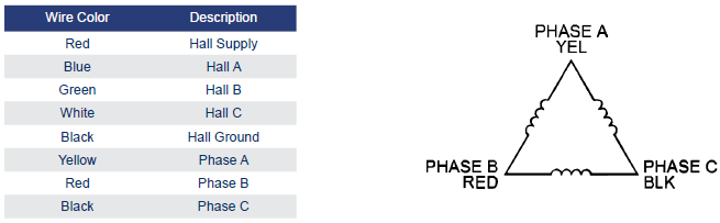

  • AS I understand, this HALL_ReadTheta function is for the 1pole pair motor, for the 4 pole pairs BLDC motor, it the HALL_ReadTheta function the same as you proved?
  • Hi Chris,
    I have done all the steps , but my motor is just shaking, not spining,why?
    I am using the DRV 8312EVM, NEMA17 motor。
  • I'm not sure which steps you have followed. The HALL Observer from this thread?
    I would check your work. Especially your phase and hall wiring. We know it works with the DRV8312 EVM with supplied motor.
