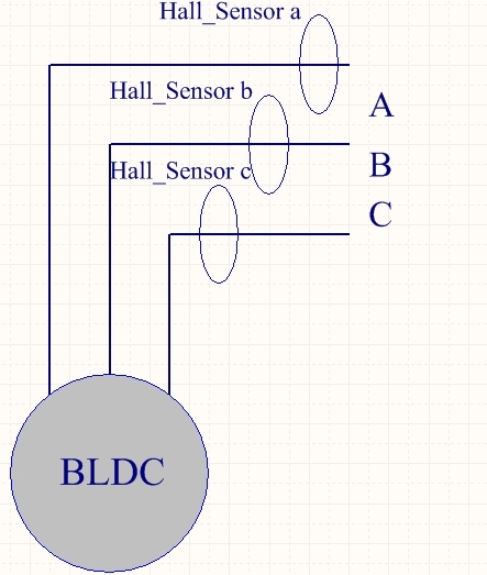

what do I need to pay attention to,if I use the hall sensor to sample phase current?
Other Parts Discussed in Thread: DRV8301-69M-KIT, DRV8301, OPA365, CONTROLSUITE, MOTORWARE
I want to design my board with InstaSPIN motion technology
Rated current:400A
Rated voltage:48V
Speed of motor(BLDC):4000-5000 RPM
I have bought Drv8301-69M-kit (60V 40A),I think I can a little changes on this kit.E.g.replace MOSFET and current sensor etc.

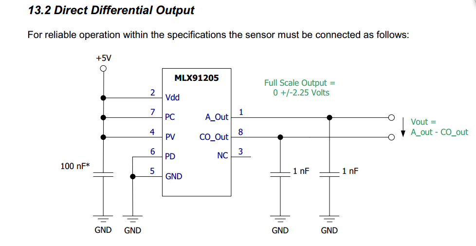

So,I use the hall sensor(MLX91205) to sample phase current. but the output of MLX91205 sensor is differential and Full Scale Output = 0 +/-2.25 Volts.
As below:
I found the CO_Out PIN don't connect GND,which equals VDD/2 in datasheet,while SP1 PIN of Drv8301 connect GND:
I am in doubt:
1.Can I connect CO_Out PIN to SP1 PIN of Drv8301 and connect ?
2.Is full scale output of MLX91205 sensor appropriate for current shunt amplifier of Drv8301?
3.Otherwise is there anything else I should do about the high current circuit?

    If the amplifier has +/-2.25V output then you should not be connecting it to the amplifier of the DRV8301. It has already been amplified.
    I think that you are going to run into some issues since this is a 5V part and the C2000 is a 3.3V part.

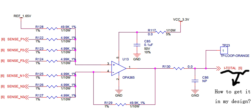

    I do My own design and have a new problems: How to design circuit to get DC bus current I-TOTAL?
    Look at my current detection circuit:
    1.I detect phase current with hall sensor(MLX91205) :

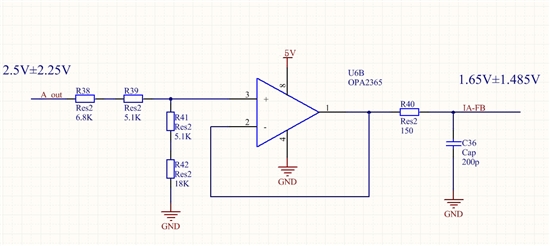

    2.I design circuit according to the manual:

    But I finally found I cannot get DC bus current (the I-TOTAL signal of DRV8301 kit)  in this way. Could you give me some advice?
  • Chris may be able to better comment here.
    In this circuit, the DC bus current is simply the sum of the 3 half-bridges. One option, you could place a sensor in the ground path where the 3 half bridges merge, but before they connect to the remaining board ground. You could also do high side sense in the supply line for the 3 half-bridges.
    This is what we would typically do.

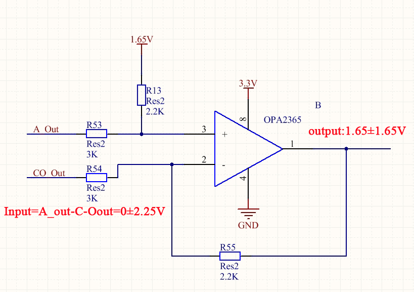

  • Hi Chris,I met some trouble in the design of hardware.
    1. A_out PIN of MLX91205 is 5V/2±2.25V under ideal conditions,but the power supply which is generated by DRV8301chip was not exactly equal to 5V.It was 5.08V.So A_out PIN of MLX91205 became 5.08V/2±2.25V,if phase current value is equal to zero,then I wil get 1.68V,not 1.65V.
    I think the error will affect motor control,therefore I have to use differential output(A_out and CO_out) form of MLX91205 and 3.3V.Because differential output voltage range is 0 ± 2.25V,I have to create an attenuator.
    But,iit feasible that change opa365 into attenuator? I fear that it generates self - oscillation or other problems
    Is there a better way to do this,if you think my idea is not good?

  • If you use hall type sensors to measure motor currents there is no difference in the code as long as the end voltage is center around 1.65V and the total swing stays withing 0.0V to 3.3V (ADC voltage). Even if the reference voltage is not perfectly 1.65 (in example 1.68) the small difference is calculated as an offset in software so don't worry about this small difference of 0.03 V.
    As far as how to calculate I_TOTAL, it depends what you have. If you have the three currents coming from hall type current sensors (non differential), then do a summer OPAMP (look for "Summing amplifier"): http://en.wikipedia.org/wiki/Operational_amplifier_applications
