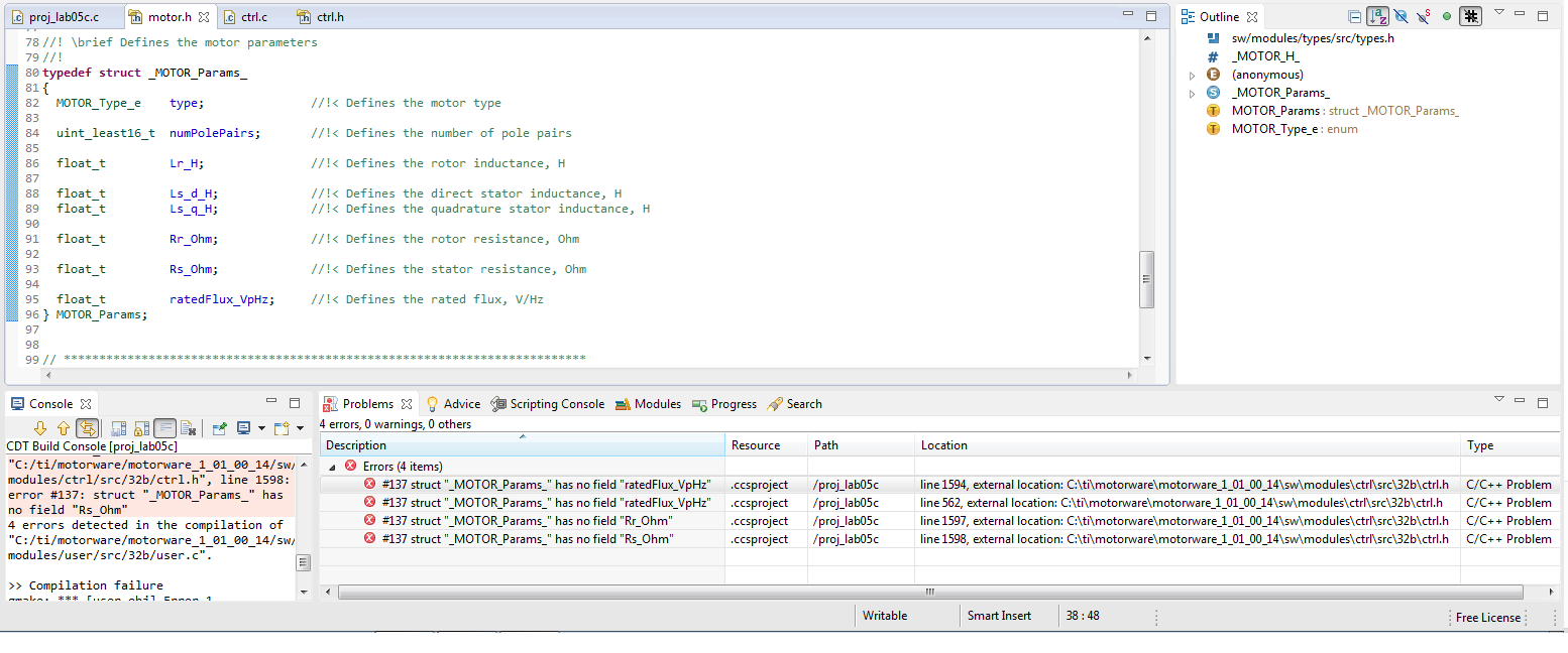

The errors I get when going from proj_lab5b to proj_lab5c are shown above. I don't understand the errors as the structure _MOTOR_Params_ includes the fields shown in the errors.
Any help would be much appreciated! Am I missing something basic here?

I just built this project (lab 05c) on a fresh copy of MotorWare without any issues. How did you upgrade your project from MW13 to MW14? Did you copy files from 13 into 14?

My upgrade process including only updating user.h from the MW13 to MW14 upgrade. Were there other files that need to be copied over?
