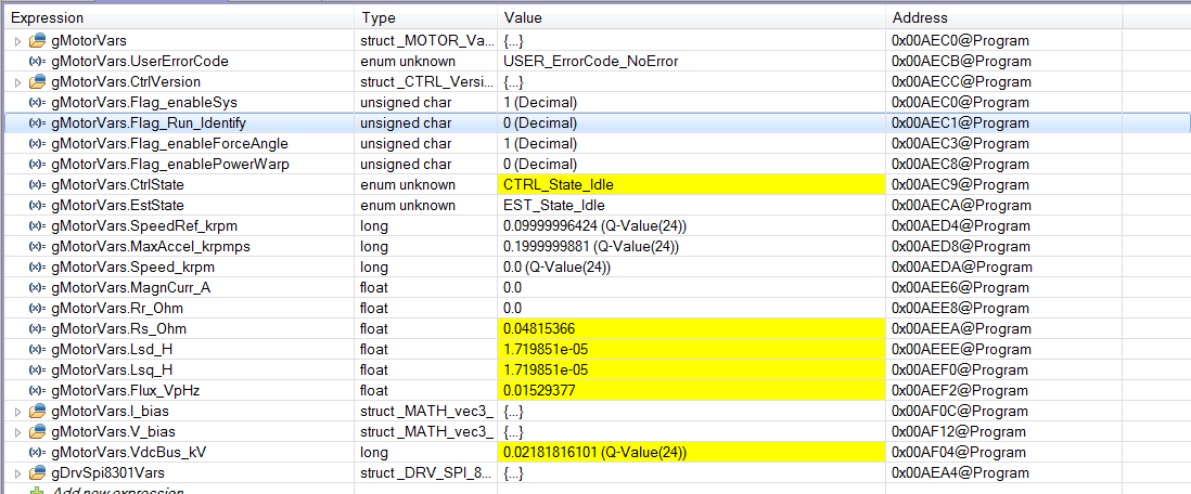

OK, Chris do you know if Tim VanderMey ever got the JM1 motor running? I am in the InstaSPIN lab2c process and have used the information above, and the spreadsheet. After I have loaded the software and enter into the debug phase, The software will not allow me to set the "gMotorVars.Flag_enableSys" variable to 1. Here is the abbreviated user.h information:

  • look at gMotorVars.UserErrorCode
    take that name and look in user.c for the logic that is setting the error
    typically you would set the USER_MOTOR Rs, Ls_d, Ls_q, and Flux to (NULL) until after you have successfully ID'd the motor...this way you won't get Errors.

  • Bingo.  Thanks.  Happy Happy.  Motor spinning!
    gMotorVars.UserErrorCode USER_ErrorCode_maxCurrent_High
    The following user.h variable was set to (40.0), so I reset it to:
    #define USER_MOTOR_MAX_CURRENT          (10.0)

  • if(USER_MOTOR_MAX_CURRENT > USER_IQ_FULL_SCALE_CURRENT_A)
    USER_setErrorCode(pUserParams, USER_ErrorCode_maxCurrent_High);
    Are you using the DRV8301 EVM? (not the BoosterPack, the full EVM)
    Because it has a default of 41.25A which will allow you to set a max current of 40A.
  • Yes, I am using the DRV8301-69M-KIT with Vishay SUM110N06-3m9H  IGBT's (60V, 110A).  Notice the spreadsheet calculation recommended:   USER_IQ_FULL_SCALE_CURRENT_A  = 18A.  Maybe I was too aggressive with the spreadsheet.  Here is my current user.h -8030.user.h
    Hmmm.  This kit is only rated to 40Amps, the IGBT are rated 110Amps.  There must be something else limiting the kit current.
  • "Notice the spreadsheet calculation recommended: USER_IQ_FULL_SCALE_CURRENT_A = 18A."
    That's because B14 is 33.0 (the default for the BOOSTXL-DRV8301.
    You need to update those cells for the hardware you are using.
    "There must be something else limiting the kit current."
    The limit is on the current sampling scaling, as defined by the gain circuits and updated in USER_ADC_FULL_SCALE_CURRENT_A
    We set this kit up in HW and SW to measure +/- 41.25A maximum
    You can change the circuit to measure more current. Make sure you update the software variables.
    SPRUHJ1 is the user guide which discusses everything you would need.
