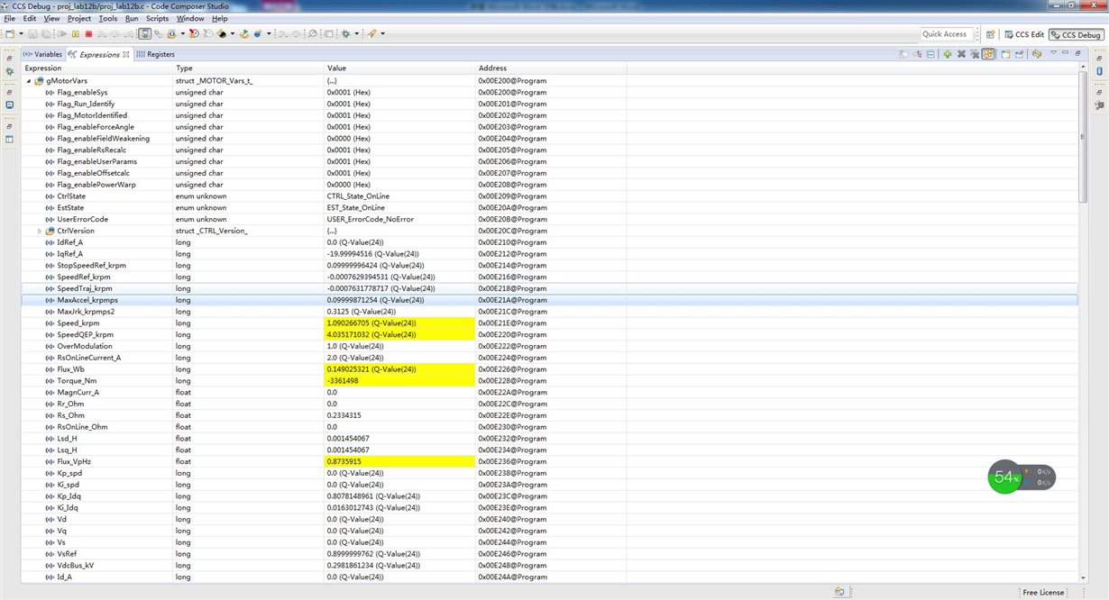

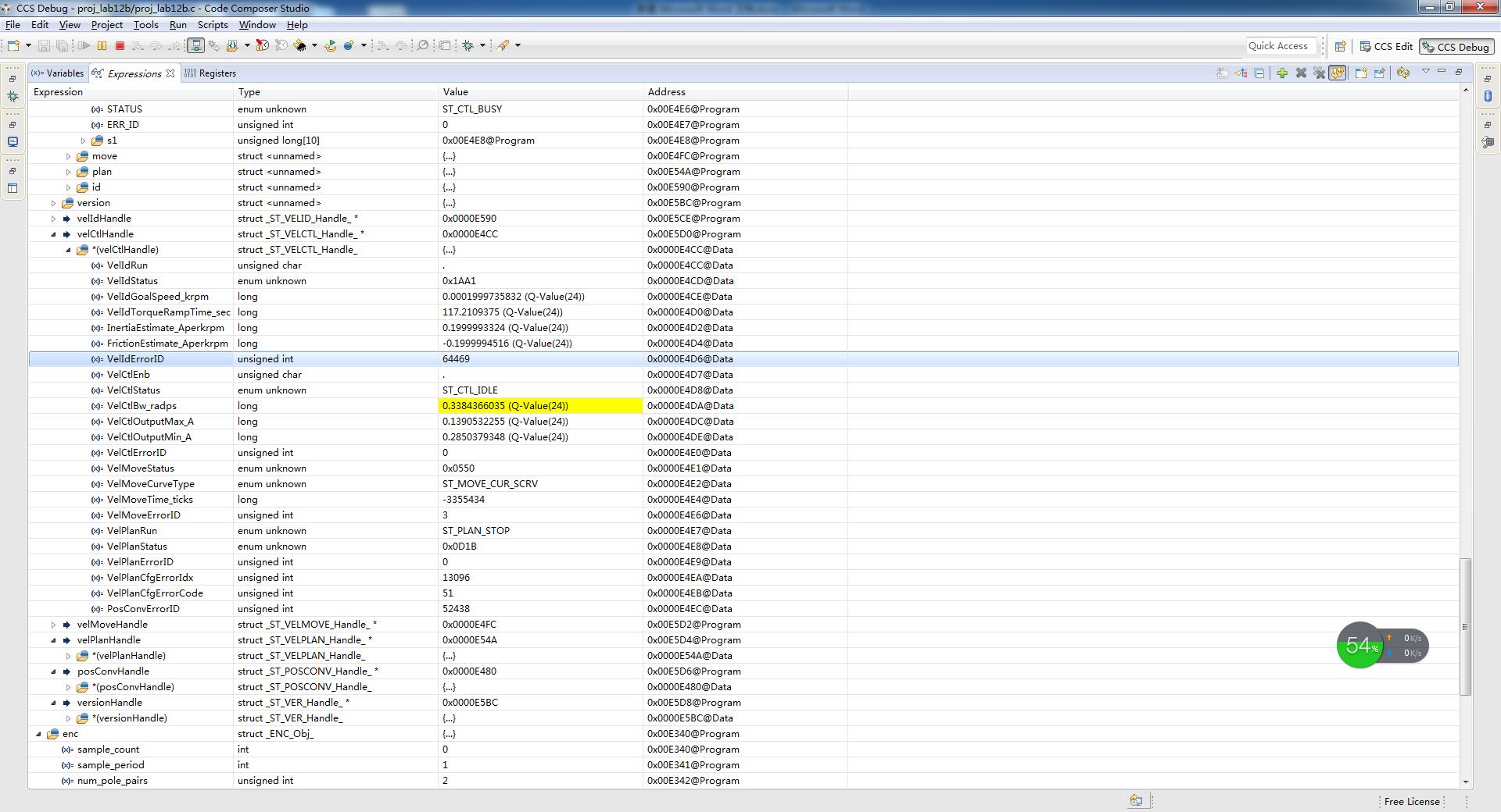

hello,
the error is when i enable the gMotorVars.Flag_enablesys & gMotorVars.Flag_Run_Identify, motor reach max speed suddenly(very fast).
and change SpeedRef_krpm value  is no effect.
and it did not happend every time,
this is the screenshot when error happend with lab12b.
  • could anyone help me analysis the reason
  • were you able to control the motor in the previous labs?
    if so, it seems like an encoder alignment issue.
  • thank you,how could I find the key of problem.
    if it was encoder error,could I find something from screenshot.

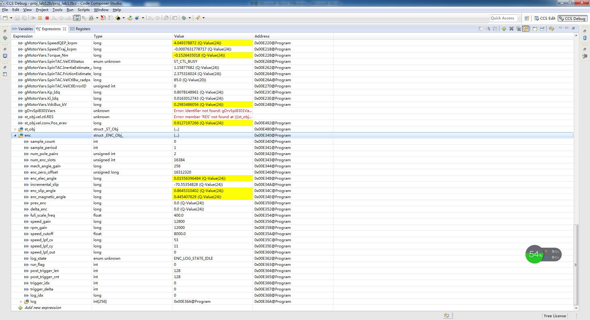

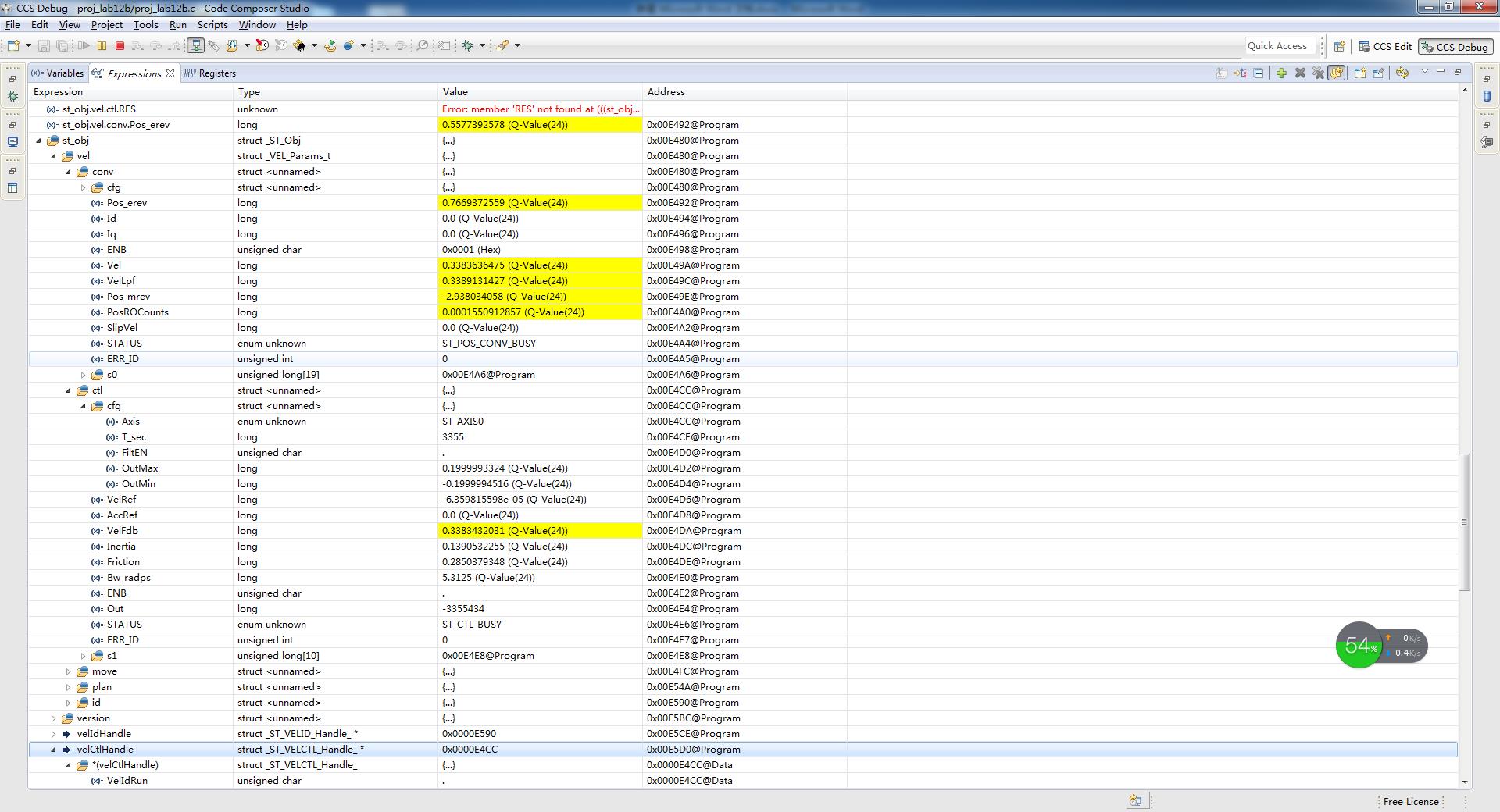

    1.what is the difference between enc_elec_angle and EST_getAngle_pu() result?
    2.i could find that elec_angle became 0 durning RSrecal , did EST_getAngle_pu() will also return 0?
    3.when RSrecal finished, motor will spin to a fixed absolutly angle everytime,
    and my USER_MOTOR_NUM_POLE_PAIRS = 2,
    the "fixed absolutly angle" have two value(maybe 110° and 290°) .
    if the motor actually aligned to a zero degree electrical angle at these two point?
    4.what decide motor spin how many angle durning RsRecal,
    EST_getAngle_pu() == 0 or elec_angle == 0, or other factor?
    5.if my max_current_res_est is too low to drive the motor during RsRecal, the error will occur(i lock my motor by hand).
    so i assume that if the motor have a very huge load and i set USER_MOTOR_RES_EST = USER_MOTOR_MAX_CURRNT * 0.5(it is really a high value), what will occur when motor still couldn't finish RsRecal correctly?
    The enc_elec_angle is the electrical angle produced by the encoder.  EST_getAngle_pu() will return the electrical angle estimated by FAST.
    I don't think that EST_getAngle_pu() will return zero since it is the angle estimated by FAST.  What is even more critical is that after RsRecalc is completed if the motor hasn't moved the enc_elec_angle will still be reading 0, while EST_getAngle_pu() will be producing invalid angles since the motor isn't moving.
    During the RsRecal the motor should move to be aligned to an electrical angle of 0 degrees.  There will be a number of these locations equal to the number of pole pairs.  The absolute mechanical location will be dependent on the motor's internal windings.
    The amount of rotation during RsRecal will be dependent on the rotor location relative to where the nearest electrical angle of 0 is.
    If the motor doesn't rotate to an electrical angle of 0, the electrical angle produced by your encoder will not be aligned with the motor and can cause a couple different failure cases.  It might have reduced torque capability or even spin the wrong direction and out of control.

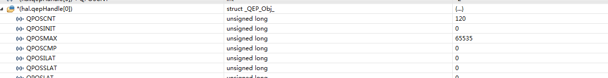

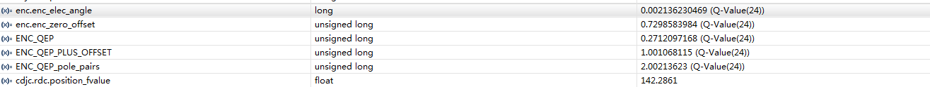

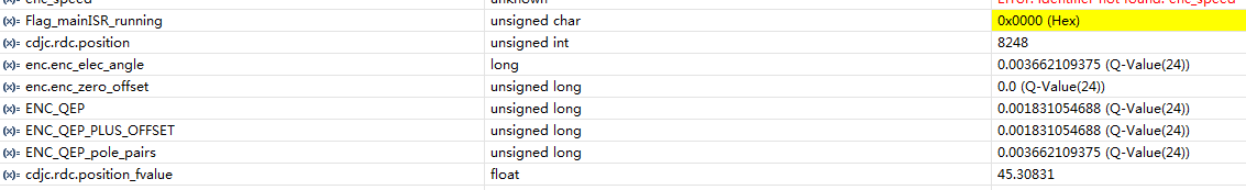

  • hello Adam,

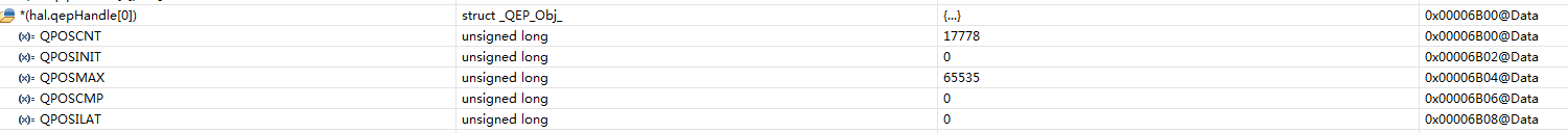

    1. this is the variables screenshot when i start up motor,
    when i power up MCU, QPOSCNT = 120
    enc_elec_angle = 0.00366,  enc_zero_offset = 0
    and this is the value that RsRecal finished, the enc_elec_angle ≠ 0.
    but you said that "motor will rotate to an electrical angle of 0", but it really have more difference.
    and motor spin correctly with the result.
    2." If the motor doesn't rotate to an electrical angle of 0, the electrical angle produced by your encoder will not be aligned with the motor and can cause a couple different failure cases.  It might have reduced torque capability or even spin the wrong direction and out of control.  "
    i want to add some funtions to confirm whether the motor rotate to an electrical angle of 0 or not.
    if the encoder can't reach the correct angle(didn't rotate any angle, or rotate to elec_angle = 0.99, mainly 1.0), it should setup error flag and disable Flag_enableSys.

  • “If the motor doesn't rotate to an electrical angle of 0, the electrical angle produced by your encoder will not be aligned with the motor and can cause a couple different failure cases. It might have reduced torque capability or even spin the wrong direction and out of control. ”
    is there any error flag in motorware to indicate RsRecal occur some problem(something make motor couldn't rotate to electrical 0)
  • 1.Which signal or condition could be used to capture the encoder count while it is passes or arrives at electrical zero?
    2.How could I know that the rotor have aligned with the stator flux?
    Yes the enc_elec_angle is not perfectly equal to 0, but for all practical purposes the value you saw 0.002136 is approximately equal to 0.  I would bet that it moved one or two encoders ticks and this is why it isn't exactly 0.
    How can I do it?
    Without having some kind of absolute motor position knowledge it would be very difficult to know if the motor and encoder isn't aligned correctly.
    There isn't really any error flags to indicate if there is some problem with the RsRecal.
    You can directly read the raw QEP position count value by using the interface functions found in the QEP block.  From this you can compare to the electrical angle from the ENC block and capture the QEP position count when the electrical angle is approximately zero.
    There really isn't a way to have a flag that indicates that the motor is aligned to an angle of zero.  In the example project we assume that enough current will be applied along the d-axis that the motor will move into alignment.
