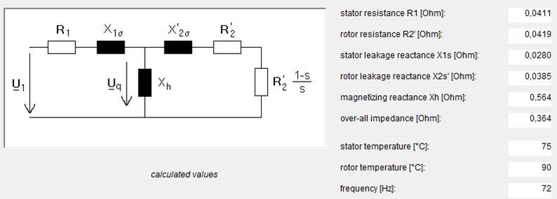

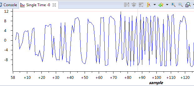

When I test my ACIM  motor by using lab13e, the motor working at maximum speed ,and I Increasing load , normally the phase voltage will reached 15V which is the effective value of rated voltage .The Vector sum of α current and β current close to 1(PU) , but the phase voltage still can not reached 15V. Let's see the pictures.

    I assume the values shown in German are the rated values of the motor, taken from the data sheet?  For example, rated current is 90.7 amps and rated voltage is 15 volts?
    Also, is the graph you included a graph of voltage?  If so, is it alpha or beta voltage, or phase voltage?
    If this is supposed to be a symmetrical AC waveform, the first thing I notice (after the fact that it does not look sinusoidal at all) is the incredible negative offset associated with the waveforms, which seems to go away after the waveform amplitude dies out.  I can't understand this.
    Also, I see that the current vector amplitude is close to unity PU, which would suggest that it is at its maximum value.  If the current regulation is working correctly, this could explain why the voltage does not reach 15 volts, since the current regulators will only apply enough voltage to achieve the reference current values for Id and Iq.

    The data sheet of the motor is upload, please check it .
    The graph is phase voltage, and the graph produced by CCS compiler and the collection frequency is very low ,so it does not look sinusoidal at all . But we still can notice the Max phase  voltage not reached 15V .
    " Why the waveform amplitude dies out "
    Sorry , I didn't describe clearly ,  the waveform amplitude dies out ,because I set the velocity to 0 .
    And My motor power can not reach the maximum , maybe the reason is the  Max phase  voltage not reached 15V.

    I did an experiment today , The input voltage source of the controller is 24V, and I increased to 30V ,  the max of phase voltage reached to 12V. (Please ignore the sinusoidal wave problem)
     Obviously , the motor run a better performance, because the voltage vector is greater , correct ?
    So,  my motor can not reach the rated power, I  suspect it is a issue of too low phase voltage , but I not sure where the problem is.
