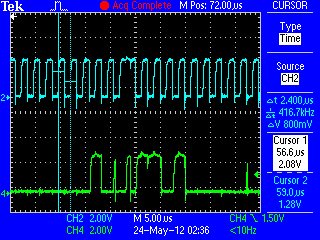

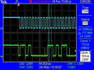

  • Hello Jens-Michael Gross,
    Thank you for your assistance.  I do see your point in having an ISR simply set a flag which then sets certain actions in the main routine, as opposed to doing a whole set of actions in the ISR.  I will re-think my approach to allow for this.
    In the meantime, I decided to do more I2C testing.  I changed the clock speed from 100 kHz to 400 kHz , and also increased the DCO speed to 8 MHz, by using the following initialization code.
    UCSCTL3 = SELREF_2; // Set DCO FLL reference = REFO
    UCSCTL4 |= SELA_2; // Set ACLK = REFO
    UCSCTL0 = 0x0000; // Set lowest possible DCOx, MODx
    // Loop until XT1,XT2 & DCO stabilizes - In this case only DCO has to stabilize
    do
    UCSCTL7 &= ~(XT2OFFG + XT1LFOFFG + DCOFFG);
    // Clear XT2,XT1,DCO fault flags
    SFRIFG1 &= ~OFIFG; // Clear fault flags
    }while (SFRIFG1&OFIFG); // Test oscillator fault flag
    __bis_SR_register(SCG0); // Disable the FLL control loop
    UCSCTL1 = DCORSEL_5; // Select DCO range 16MHz operation
    UCSCTL2 |= 249; // Set DCO Multiplier for 8MHz
    // (N + 1) * FLLRef = Fdco
    // (249 + 1) * 32768 = 8MHz
    __bic_SR_register(SCG0); // Enable the FLL control loop
    // Worst-case settling time for the DCO when the DCO range bits have been
    // changed is n x 32 x 32 x f_MCLK / f_FLL_reference. See UCS chapter in 5xx
    // UG for optimization.
    // 32 x 32 x 8 MHz / 32,768 Hz = 250000 = MCLK cycles for DCO to settle
    __delay_cycles(250000);
    // Initialize I2C Port
    P4SEL |= 0x06; // Assign I2C pins to USCI_B1
    UCB1CTL1 |= UCSWRST; // Enable SW reset
    UCB1CTL0 = UCMST + UCMODE_3 + UCSYNC; // I2C Master, synchronous mode
    UCB1CTL1 = UCSSEL_2 + UCSWRST; // Use SMCLK, keep SW reset
    UCB1BR0 = 20; // fSCL = SMCLK/20 = ~400kHz
    UCB1BR1 = 0;
    UCB1I2CSA = MPU6050_ADDR; // Slave Address is 068h
    UCB1CTL1 &= ~UCSWRST; // Clear SW reset, resume operation
    UCB1IE |= UCTXIE + UCRXIE; // Enable TX interrupt
    I took some oscilloscope tracings, which I have attached here.  It seems as if the 400 kHz tracings are quite noisy (what do you think).  I just want to make sure I'm not violating any rules.
    100 kHz
    400 kHz
    Sincerely,
    Mehdi
