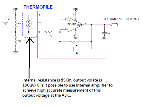

the input impedance is about 200~400K. If I am going to use it with a thermopile,I want to connect the thermopile
directly to the amp inside this MPS430i202x. can I get high accurate measurement on the output of ADC side?
my design target is to use an analog thermopile and MPS430i202x to build a thermometer with minimum component count. thanks

    • Both systems seem to be single-ended outputs, do you plan on grounding one of the inputs and operating the SD24 like a single ended ADC?
    • Have you thought of using a thermistor conditioning circuit similar to figures 1 or 2 in this link: http://www.ni.com/white-paper/3643/en/? This would take advantage of the differential measurement inputs of the SD24, and may yield better results.
    • For your thermopile design, will the contents in the red box be removed or still be there external to the MSP430?
    • What accuracy over what range of temperature are you looking for?
    • What voltage outputs do you expect across your thermistor/thermopile?
    A large factor to getting the most accurate results will be ensuring that the output differential voltage of your signal conditioning circuit is well aligned with the 1.16V reference. You can use the internal PGA to help with this, but any use of the PGA will add noise to the system.

    I don't have a very clear solution yet. I hope the measurement could meet the standard body temperature requirement, that is 0.2 degree Celsius accuracy between 35 to 42. I can use differential input if this can improve the measurement accurate. I hope the design to be simple, if a signal conditioner is required to achieve the measurement accuracy. I will use one.
    for the red box, I don't know it is needed or not, I calculate it like this.
     the thermopile output signal is around 0V at 25 degree Celsius and 0.05mV/degree C. for 16 gain of the TI MCU. it will be 0.8mV/degree C.
    ADC is 24 bits. assume I only use 20bits, for 1.16V reference, the resolution will be around 1uV. it is 1/800, should be good enough for my application. I am not sure my calculation working or not.
    I don't want the red box in my design, but If my calculation couldn't provide the resolution, I will use it in my design.
    for thermistor I can use a WHEATSTONE BRIDGE, or a signal condition circuit. so the voltage will be easy to control.
    I am designing a consumer device, so the cost is sensitive. of cause for a measurement device, the accuracy is the most important.
    if TI has a application note for a IR thermometer, that will be great for me to start my design.
    i20xx may not be the best candidate, the reason I pick it because it is small,  has 24bit ADC and not expensive.

    As for the design side, I can say that the i20xx series is a great selection for precision sensing and low cost point. You can expect 14 ENOB for AC signals, or close to 16 ENOB for DC signals from the SD24 module. This means you should easily meet the 0.2degC accuracy over your range.

    • For the thermopile design, you can replace the red box with the internal PGA of the i20xx and gain the signal up to a level which should provide ample accuracy for your test case.

    A thermopile, however, is a voltage source. The voltage depends on temperature. In the second circuit, the resistor divider acts as offset voltage generator (so the OpAmp doesn’t have to operate near the negative rail, which would reduce precision, subtract offset voltage and increase operating current, if supported at all), the red box acts as amplifier and impedance changer. In theory, you can directly attach the thermopile to the two inputs of an SD16. However, you should still use the voltage divider to put the negative side on a defined voltage (or put it to GND directly and use the SD16 in single-ended mode)
    SD16 input impedance is a problem, as the thermopile has 85K internal resistance. MSPs with input buffer on the SD have better (higher) input impedance. Or you have to live with it and count this in into your calculation (effectively a voltage divider, calibration needed)
    Of course, Tyler's soluton with a bridge is the most elegant one, but calibrating the bridge is not trivial.

    I'm not familiar with all of TI's thousands of analog products, but I do know we have the TMP006 which is an IR Thermopile + 14-bit ADC which can then communicate to a generic MCU via I2C. The TMP006 will be accurate from 0 - 60C, so it should encapsulate your target range quite well with sufficient accuracy.
    This part is quoted at $1.50/1ku, and would take the responsibility of the ZSSC3218 and your thermopile sensor all in one, which could save costs considerably.
