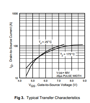

    sort of like this http://grobotronics.com/mosfet-irf540n-n-channel-33a-100v.html?sl=en

    The basic circuit looks reasonable for what you are trying to do, but I do not think that this is the best FET to use.
    If you look at the datasheet for the FET you will see that the Vgs threshold is specified as 2.0 to 4.0 V, amd the Transfer characteristic is
    With the MSP430 powered from 3.3V this FET will noyt switch ON fully.
    You need to be looking for a "Logic Level FET". that will turn on fully with a Vgs of 3.3V. A very quick google search indicates that the FQP30N06L may be a better device, as it operates with a lower gate voltage. As the motor is an inductive load you may also need a diode to suppress back emf when the FET switches off.

  • The higher the maximum current of a FET and the lower the ON resistance, the higher (usually) the gate threshold Ugs. Below Ugs, the gate voltage has no effect. Above, Ids begins to rise until minimum resistance (or rather: maximum current) is reached.
    So the FET you picked maybe won't drive any current at all with a gate voltage of 3.3V.
    MOSFET transistors don’t need a free-wheeling diode, as they have one inside by design.
    Don’t have a too-large series resistor. The FET gate actually is a capacitor. So without series resistor, you have a pure capacitive load on the signal pin. But with a too-high resistor, the gate will charge slowly, keeping the FET in an intermediate state (not fully on) for quite some time, significantly increasing the power dissipation on the transistor.

    In my datasheet collection, thee is the IRLR6225PbF. It has a threshold voltage of 0.5 to 1.1V (that’s really low) and drives up to 42A continuous current (up to 200A peak) with 3V gate voltage. However, it’s maximum operating voltage is 20V. Don’t ask me where to get it.
    Another one is the IRL540N is another one, with 1-2V threshold and 36(120)A. With 3V gate voltage, it won’t get higher than 13A, with a resistance of 70-125mOhm (depending on junction temperature). Keep an eye on the power dissipation (13A/125mOhm means 21W) - without cooling (plain PCB mounting), the limit would be 2W = 4A.
    It’s not easy to pick the right FET just by the parameters listed on a typical catalogue page. You’ll have to check the datasheet for the details, before you know whether a FET can be used for your application at all (let alone finding the best one).
