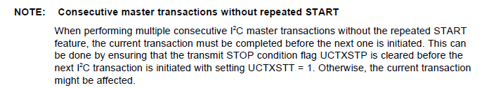

1.My suspicion is that the MSP is not ready to transmit the next byte. I am checking this by polling the TxIFG flagIs there any other way to do this so it works. ?
2. I was reading a section in the user guide and need some help understanding what it really implies.
Is this the solution to my problem ? Or is this just talking about two different transactions ? The slave device does not require repeated starts to be sent out.

  • Your code is a bit confusing. Why do you use HWREG8 with base and offset, and on the next line use UCB2CLT1 as absolute register address? Either use the indirect version (which is more suitable for library code that shall be used with different USCI modules) or use dedicated register names, but please don’t mix them.
    With the code excerpt you posted, I cannot even be sure that baseAddress refers to USCIB2 at all.
    However, it looks like the USCI is not generating the clock pulse for the final ACK.
    When TXIFG gets set, it indicates that the USCI is ready to receive a byte in TXBUF. IT does not mean that the previous byte has been sent yet. Or that sending will take place immediately. Writing to TXBUF clears it and you shouldn’t write to TXBUF again until TXIFG is set again.
    I’m a bit surprised that it works at all. Normally, after setting UCTXSTT in transmit mode, it won’t clear (not complete the start byte) until something is written to TXBUF. Which you don’t. This makes me suspect that you’re messing with two different USCI modules here, and ‘base address’ does not refer to USCIB2.
