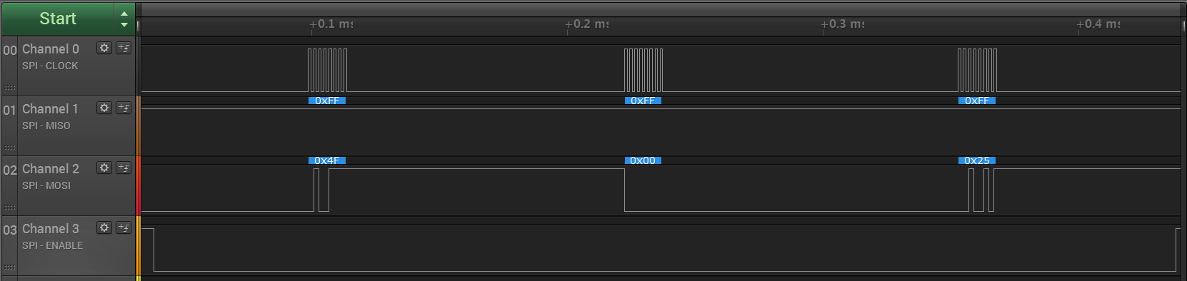

While I have SPI working correctly on the MSP430FR5969, there are a few intervals that seem much larger than expected. The following logic analyzer capture is for 3 wire SPI with a software controlled CS pin. It is transmitting 0x4F, 0x00, and 0x25 (correctly). For this test, MISO is left floating. SMCLK = 1 MHz.
I believe the issue is two-fold. First, after the CS pin is toggled and UCA1TXBUF is written to, there is a very long delay before data transmission starts. I know that I am not using DMA, but should the delay really be this large? Second, the delay between bytes also seems unusually large.

The delay seems much longer than what it would take to execute the code in the service routines and transfer the data to and from the eUSCI buffer registers. Does anyone have any suggestions? Have I set up the eUSCI incorrectly? Even if it did take that long between bytes, why does it take so long for the first byte to be sent after writing to UCA1TXBUF?

  • What does buffer_read() do exactly? Have you timed it?
    Just for some perspective: With UCA1BR=2, each byte (burst of SCK on your analyzer) is 16 clocks. I estimate that your post-/CS delay is about 3x of these, or about 50 clocks. That time is spent almost entirely in buffer_read(). It's not that difficult to burn up 50 clocks in even a simple function. Just getting there and back might cost 20 clocks.
    More generally, it's not easy to achieve maximum throughput over the SPI without DMA. It's harder if you have to make a non-trivial decision about each byte. It's even harder if you feed it with an ISR, which has its own overhead. (An ISR does make good sense if you're running the SPI very slowly, but that's not your case.)
  • In addition to Bruce's reply, you're losing some time by not parallelising load of TXBUF with the eUSCI transmission. Waiting for RXIFG to be set before loading the next byte for transmission forces the CPU and eUSCI to "take turns", with each waiting for the other to finish before continuing.
    TXIFG goes high at the start of a byte transfer, as soon as TXBUF has been copied into the TX shift register. Loading TXBUF when TXIFG goes high means the CPU can safely start work while the eUSCI is still busy shifting the current byte out onto the line.
