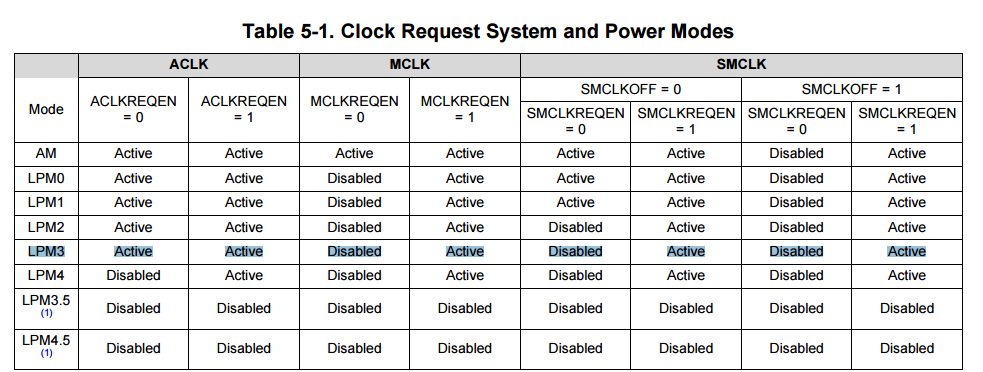

I have an MSP430F5438A capturing a test tone of 1kHz using the ADC12 module. The ADC12 module is clocked from SMCLK/2. The trigger from the sample timer is sourced from Timer B. Timer B is sourced from ACLK. SMCLK is from the DCO/FLL referenced to XTAL1/ACLK.
If I use low power mode is 1, the stored samples are noise free - almost perfect 1kHz tone. If I then use low power mode is 3, to save more power, the stored samples are noisy. If I periodically enter lpm1, I see the noise go away.
My understanding is that the difference between lpm1 and lpm3 is that the DCO Generator is also off and that SMCLK is disabled. But why does it work at all? There is no frequency drift, just noise. To further prove this, if I increase the sample time the noise goes away. So it definitely appears to be an interaction between the SMCLK and the Sample&Hold.
Additionally, I am thinking of testing lpm1+SMCLK vs lpm3+ADC12OSC, to see which is lowest power - if indeed lpm3+SMCLK is not a valid configuration.
Your thoughts would be greatly appreciated.

  • Hi Ryan,
    I am still not satisfied with this answer.
    Ryan Brown1 said:
     Therefore LPM3 is not recommended with an ADC12CLK sourced from SMCLK since said clock is disabled in this low power state as stated by Table 1-2 of the Family User's Guide.
    I agree from your table. But if you look at table 5-1, it suggests that in lpm3 SMCLK can be requested.
    Another way to think about this is, if the clock is disabled, then how am I getting conversions at all? I appreciate sometimes the samples are noisy. The noise reduces by increasing the sample time period (e.g. 16x ADC12CLK to 128x ADC12CLK).
    So my architecture is Timer B (aclk) ->ADC Trigger->ADC (smclk)->DMA Trigger->DMA Channel-> RAM = no Interrupts. If your comment was true, then I would never ever get data as I never exit lpm3. It certainly seems that in lpm3 the ADC12 module can still request the SMCLK to be turned back on. Please can you confirm this or otherwise explain what I am seeing?
    My solution for now is to use a higher sample time period to reduce the noise in the signal, but this is consumes more power. My concern from what you are saying is that I must understand if this is some sort of fluke/undefined/undetermined use of the MSP430. If you could please double check this/find a strong evidence for this, then we can agree the source of the adc noise which I suggest currently is due to the wakeup time of the DCO (~3.5us).
    Best Regards, James
  • Hello James,
    Table 5-1 does look promising and seems to imply that SMCLK may be on while in LPM3, which then explains the noise due to the DCO wakeup time.  SMCLKREQEN is zero by default, are you intentionally setting this pin in your code?  If this is the case then you are most likely not benefiting from any power savings by being in LPM3 as compared to LPM0/1.
    If what you are saying is true and you really are in true LPM3 mode without any interrupts then the DCO should never wake up. It may be possible that SMCLK never turns off properly due to errata UCS6, are you by any chance using a USCI configured in UART mode in your project?
    Can you use ACLK to source ADC12CLK or would 32768 Hz be too slow for your application?
    Ryan

  • Hi Ryan - many thanks for your continued support.
    I am seeing a power saving between LPM1 and LPM3 - and this is why I really want to get to the bottom of this. According to Table 5-11 SMCLKREQEN is one by default.
    I apologize James, I shouldn't have assumed the initial state of the SMCLKREQEN bit.
    James Hillman said:
    what else is turning off to reduce my power in LPM3?
    Knowing now that SMCLK is active and sourced from the DCO, I agree with you that the DCO wakeup time has a part in this issue.
    Ryan.
    I would be greatful if you could at least confirm that using lpm3 + adc smclk is valid i.e. intend to be used like this.
    Since the SMCLKREQEN bit is set to activate SMCLK while operating in LPM3 it is safe to assume that using the ADC12 sourced by the SMCLK while in LPM3 is a valid format.
    Ryan
