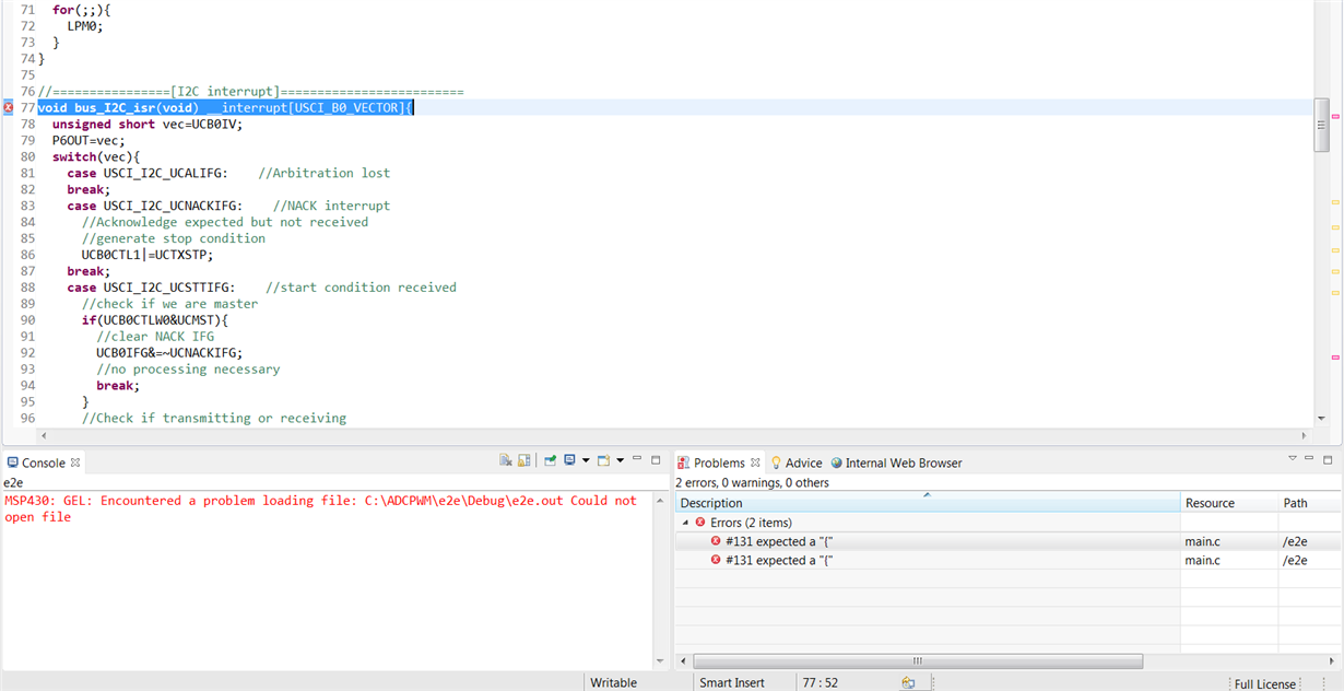

  • Hi Jesse,
    Sorry for the late reply, I'm currently using CCS to compile the code and test on a target board,  there are errors concerning the "{" usage with both I2C interrupts. I don't know why this error exists, are you also using CCS?
    Additionally, on line 142, there is an extra break statement in the I2C interrupt code:
    Maybe that is the reason for your missing transmission.
  • I am using Rowley CrossStudio 3.0 I suspect the problems may be related to how CCS expects you to declare interrupts and that may need to be adjusted.
    I am not sure why the extra break is there, probably a coppy-paste goof up. Regardless the first break should cause code execution to leave the switch statement making the second break unreachable and have no effect.
    The question is not "why do I not send the correct data" but "why does the I2C respond to itself." The missing transmission is caused by getting receive interrupts which cause the index to be incremented more than it should. This could be fixed by changing how the indexing is done but I would rather understand why I get these interrupts in the first place.
  • That interrupt definition needs to change from:
    void bus_I2C_isr(void) __interrupt[USCI_B0_VECTOR]{
    to:
    #pragma vector = USCI_B0_VECTOR
    __interrupt void bus_I2C_isr(void) {
    in order for it to build using the TI MSP430 compiler rather than Rowley CrossStudio as used by Jesse.
