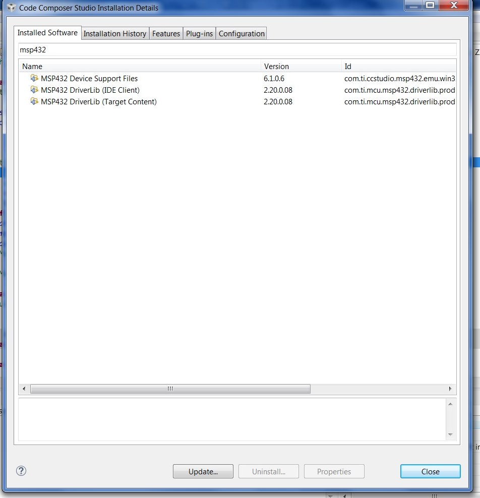

    Sorry for the late reply, I am in training all of this week. The issue is that the debugger hardware is recognized, however, a firmware update cannot be completed for the debugger. To make sure MSP432 drivers are installed in CCS, go to Help->Installation Details. The below screenshot should help verify driver installation.
    The launchpad is working since the startup program can boot on the Launchpad, the issue is the debugger connection. The hardware is recognized, however, the firmware update utility cannot connect. A probable cause after verifying drivers and assuming the debugger is functional, may be a faulty USB connection, so could you try to connect via another USB port?

    I went to have a look and all of those were installed.
    but before going to try one last time with a new USB port (had already tried more than one) , I noticed a new download had become available - for the MSP432 emulator?? anyway - I downloaded and installed that, then plugged in my MSP432 board and hit debug - it came up with a different issue (emulator needed update) so I let it do that, and now I'm in debug!! thanks so much for your help. It looks like this latest update fixed my particular issue...
