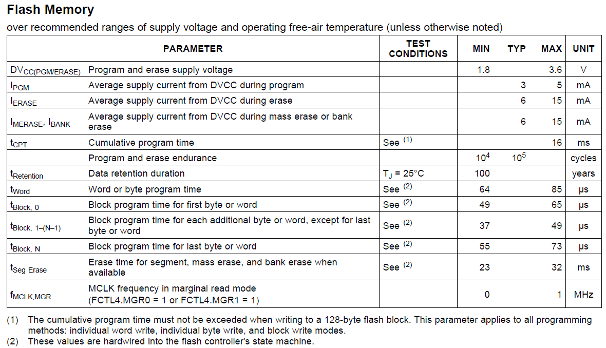

May I know what is the F6459's current consumption while performing a write and read for the whole block of 512kB flash? And what is the maximum time for doing a write and read for the 512KB flash?
Thanks and best regards,
Lee

Kum Hoo Lee said:May I know what is the F6459's current consumption while performing a write and read for the whole block of 512kB flash? And what is the maximum time for doing a write and read for the 512KB flash?
Smart write is not covered by TI documents. If you are looking for shortest writing / minimum current consumption, answer is smart write (200 KByte/s). My flasher can write (depending on target device) 512 KByte in 2.6 seconds.
http://forum.43oh.com/topic/2972-sbw-msp430f550x-based-programmer/?p=47182
