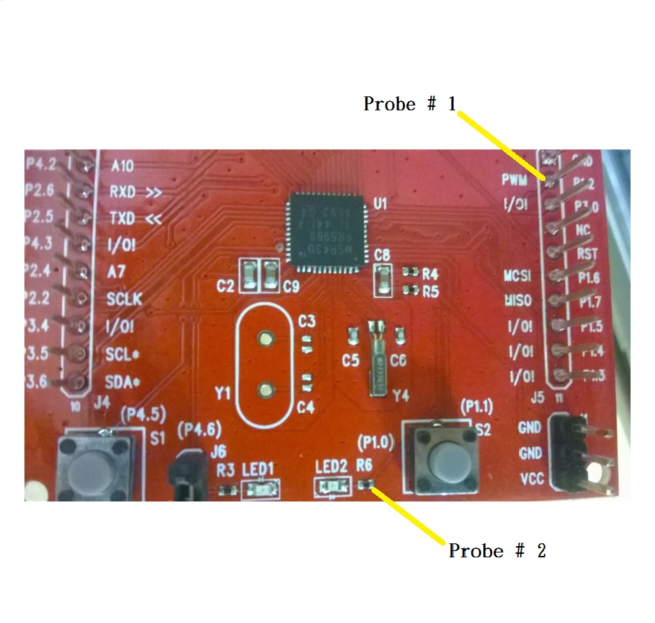

  • One more doubt. Cant I use both P1.2 and P1.3 from T A 1 and get a delay between them?
    because the ports 1.6/2.3, P1.0, P1.1 are not accessible to get the output from hardware

  • P1.2 and P1.3 can be used for PWM signals generated by TA1 CCR1 and CCR2 respectively. They can have different pulse lengths, but will always either start at the same time, or end at the same time. (I think you have already tried this.)
    If you are just using a scope probe to verify the signals, P1.0 is accessible at the right-hand end of R6 next to LED2.
  • Yes, I've tried that P1.2 and P1.3 thing. The P1.0 is not a port right. It's a switch in my controller
  • No, P1.1 is the switch. As OCY said: "...right-hand end of R6 next to LED2" - P1.0 is connected to the LED.
  • So how to get the output out of the switch?
    I mean which port to connect as there is nothing behind the switch

    The pin the switch is connected to should be configured as an input. Of course you can use it as an output, but then you should not press the switch because...
    ..."behind the switch" is GND - you would short the pin.
  • This is what I understood - that P1.1 must be given as input to some other port like P1.7 so that we can actually get the output from the port to see that in hardware. Right?
  • Sorry, I shouldn't have said that. I will try to explain in a few minuets.

  • Sun, Nov 8 2015 10:33 PM, old_cow_yellow:
    Sun, Nov 8 2015 10:46 PM Yashaswy Akella:
    The P1.0 is not a port right. It's a switch in my controller.
    Sun, Nov 8 2015 11:27 PM Dennis Eichmann:
    Sun, Nov 8 2015 11:34 PM Yashaswy Akella:
    P1.0 is not a switch
  • Oh sorry, now I get it OCY. As Dennis said that we can send the output from P1.0 internally to another hardware port where we can connect the probe of our oscilloscope, I actually liked the idea. Can you tell me how to do it. Also please check the message I sent you. Thank you.
